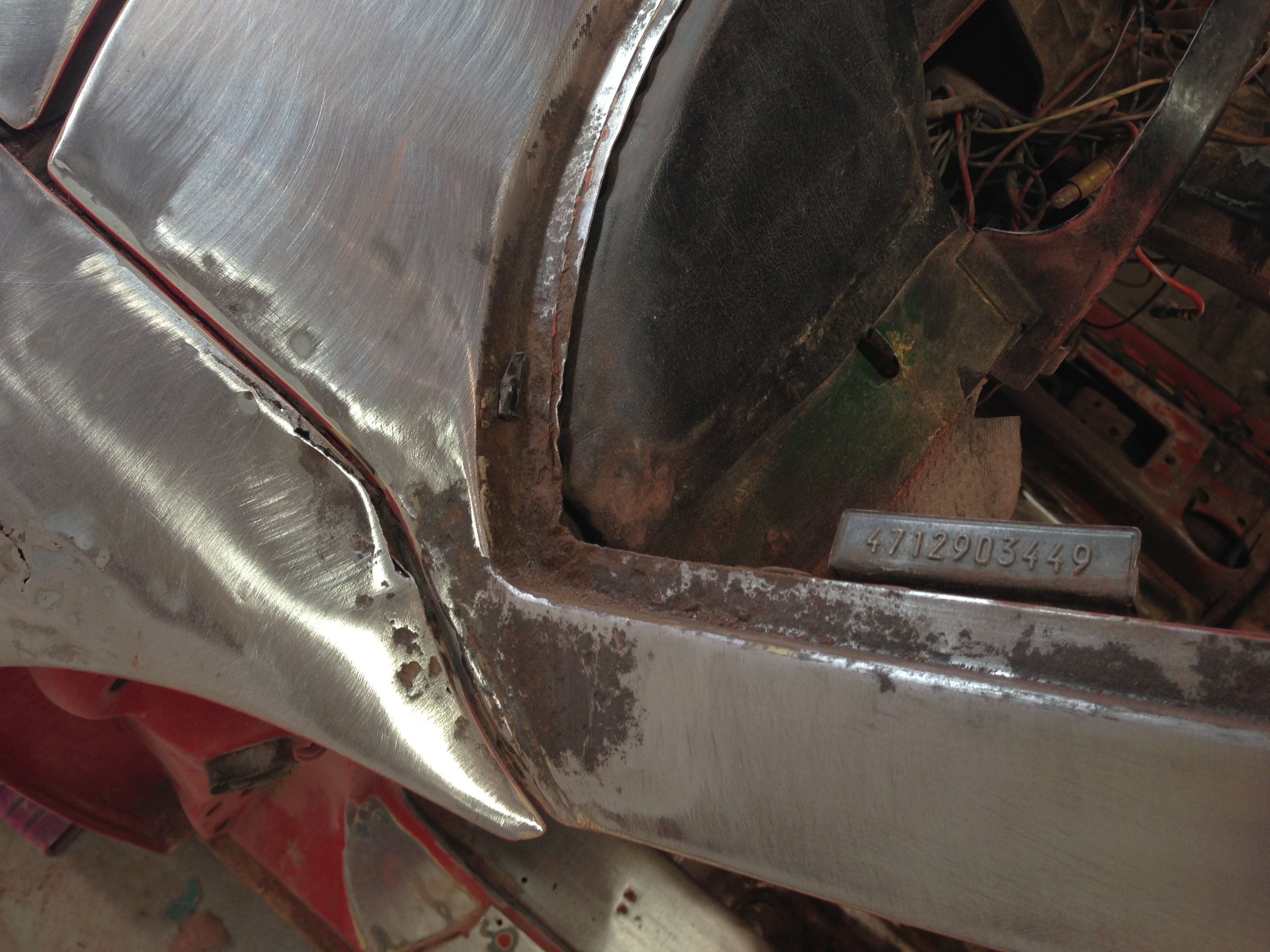

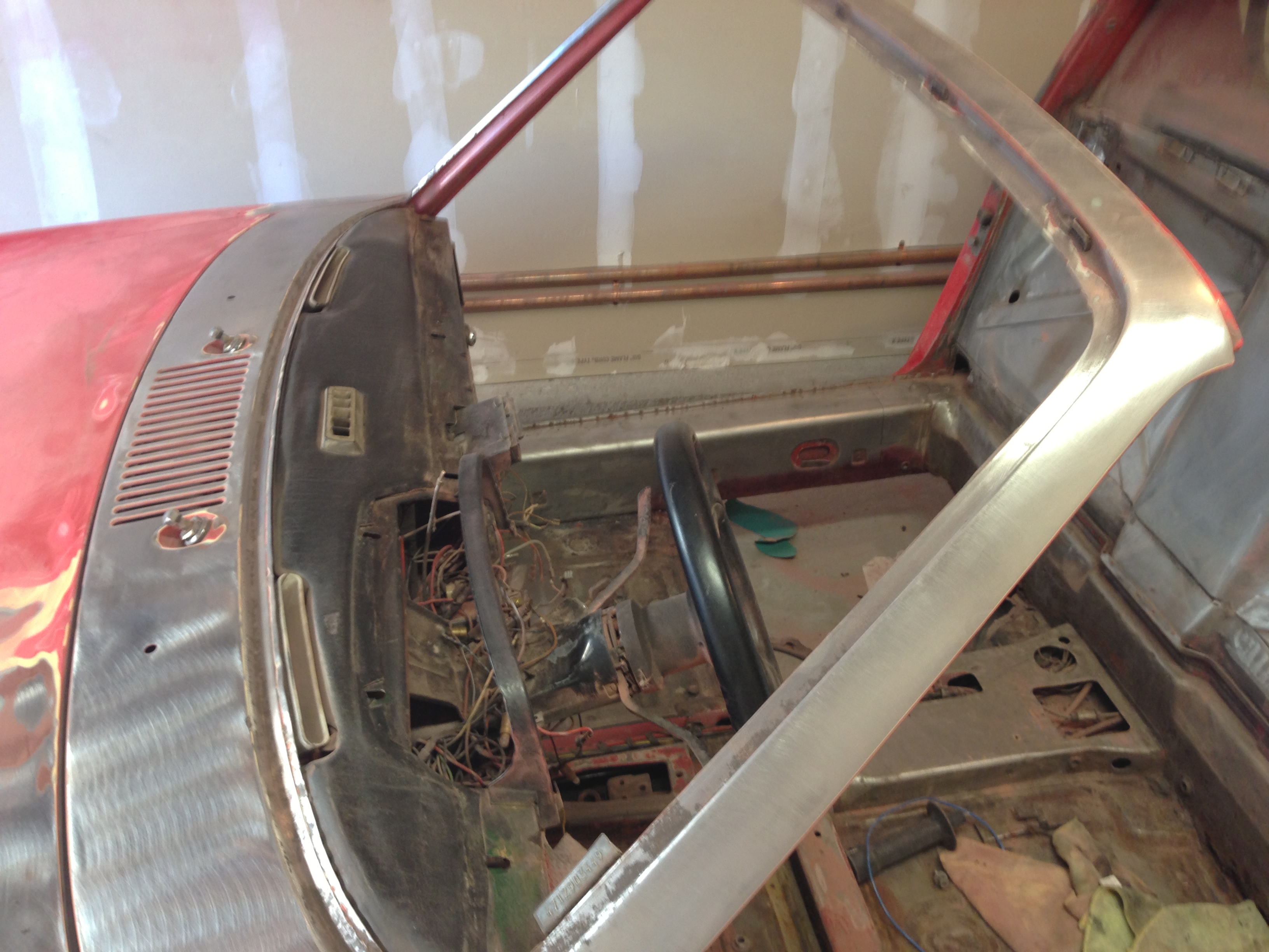

well worked on it for about an hour got the windshield frame stripped along with the front cowl not as much rust as i thought what would you guys do in my situation as far as preping the rust spots for paint cut and weld or rust treatment ? its not thin enough to poke through

ONTHEGRIND   well worked on it for about an hour got the windsh...   Nov 23 2012, 03:18 PM
ONTHEGRIND   more pics   Nov 23 2012, 03:20 PM
ONTHEGRIND   one more until after my lunch   Nov 23 2012, 03:21 PM
