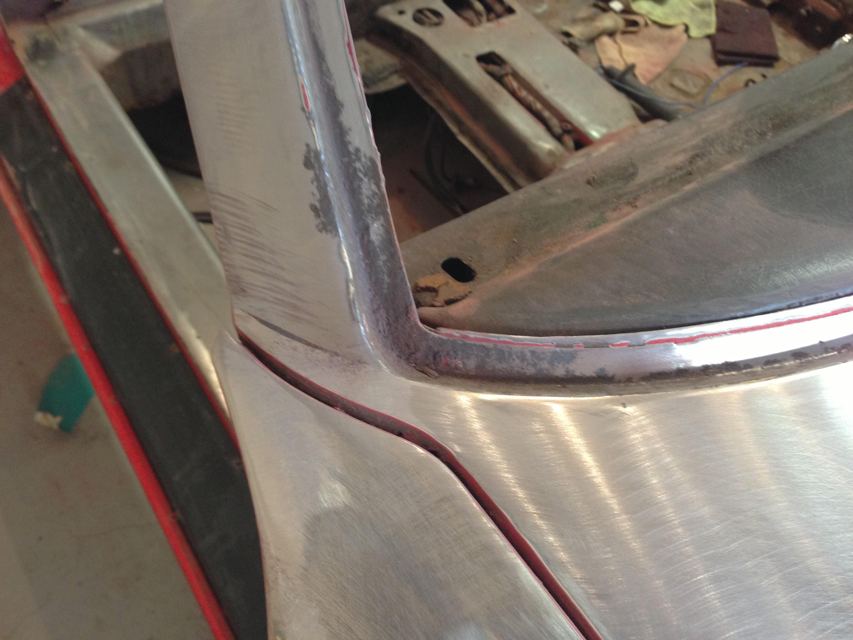

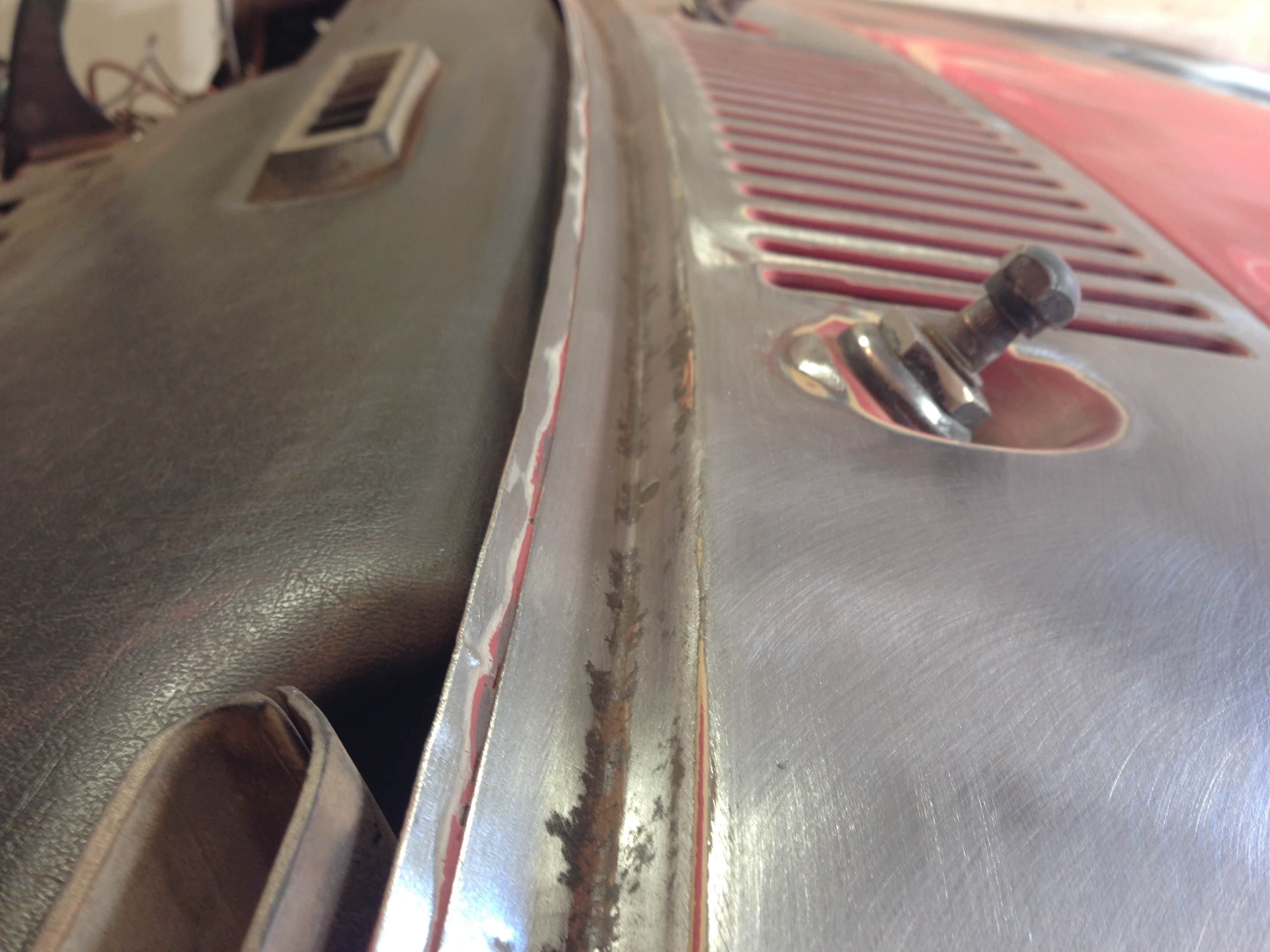

ONTHEGRIND   well worked on it for about an hour got the windsh...   Nov 23 2012, 03:18 PM
ONTHEGRIND   more pics   Nov 23 2012, 03:20 PM
ONTHEGRIND   one more until after my lunch   Nov 23 2012, 03:21 PM
