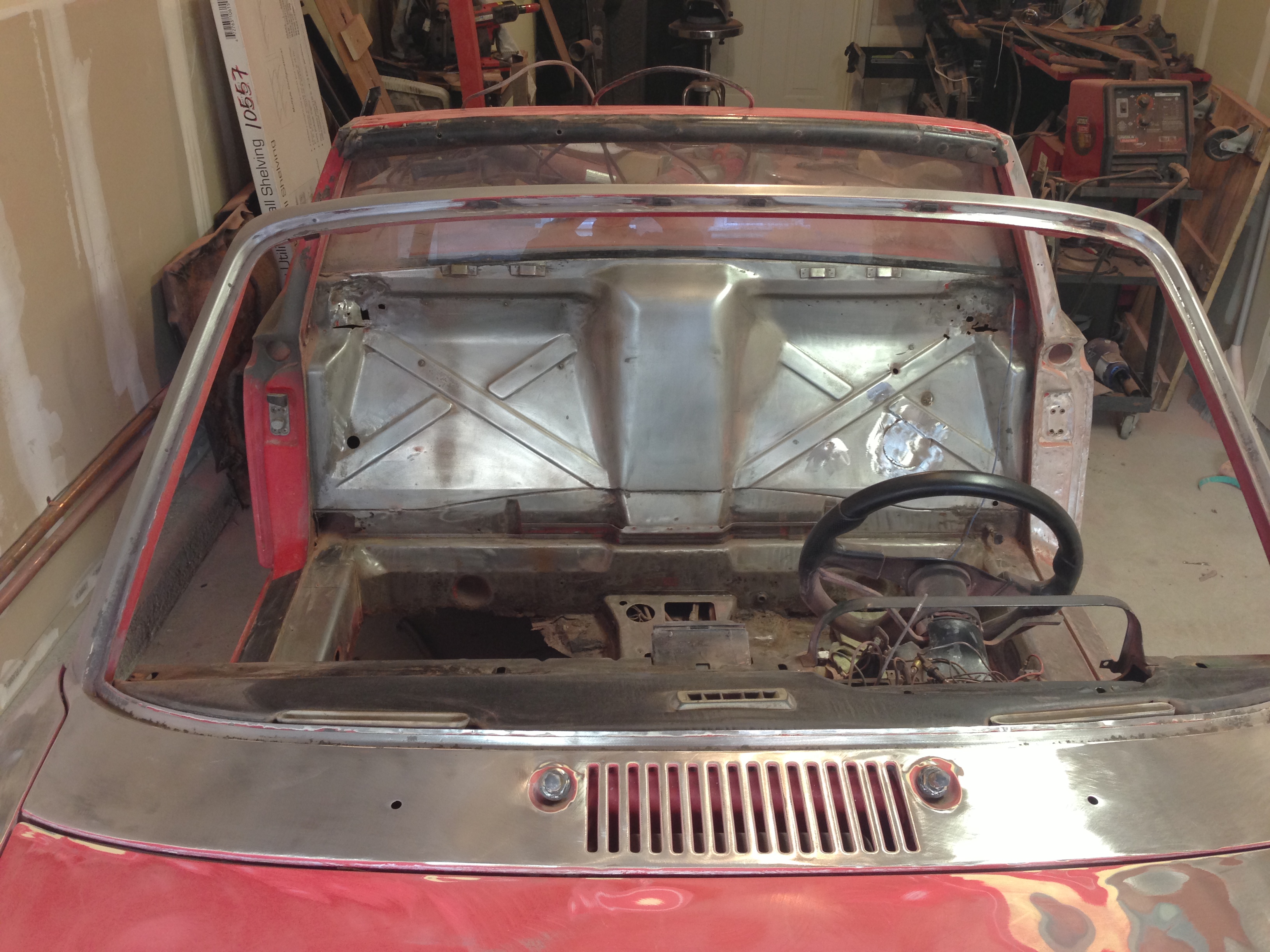

ONTHEGRIND   so i got a little lazy and only did about an h...   Nov 18 2012, 07:25 PM
ONTHEGRIND   this is the ugly part looks like the p/o hamme...   Nov 18 2012, 07:30 PM
ONTHEGRIND   firewall   Nov 18 2012, 07:30 PM
ONTHEGRIND   door jam had alot of bondo..   Nov 18 2012, 07:32 PM
ONTHEGRIND   Little rust repair   Nov 19 2012, 09:28 AM

ONTHEGRIND   Stripped the good today and the left front 1/4 goi...   Nov 24 2012, 05:45 PM
ONTHEGRIND   one more   Nov 24 2012, 06:12 PM
Andyrew   What grit are you using to strip it? Looks like it...   Nov 24 2012, 07:31 PM
ONTHEGRIND   Using 3m green 80 grit 8 Inch disc on a soft pads ...   Nov 25 2012, 11:10 AM
ONTHEGRIND   Well ran out if time an hour a day.. was going to...   Nov 25 2012, 10:51 PM
ONTHEGRIND   Few more   Nov 25 2012, 10:55 PM
SirAndy   Where is your bracing? :huh: I wouldn't rem...   Nov 26 2012, 12:43 AM
ONTHEGRIND   Was going fab up something at the shop tomarrow I ...   Nov 26 2012, 01:52 AM

ONTHEGRIND   I was looking at door braces last night, I think I...   Nov 26 2012, 09:04 AM
r_towle   well. The front part hangs off a flexible area tha...   Nov 26 2012, 04:19 PM
ONTHEGRIND   Any pics ?   Nov 26 2012, 04:29 PM
SirAndy   Any pics ? A simple search for "+floor +br...   Nov 26 2012, 05:09 PM
ONTHEGRIND   I'm only removing the inner firewall skin you ...   Nov 26 2012, 04:32 PM
SirAndy   I'm only removing the inner firewall skin you ...   Nov 26 2012, 04:58 PM
ONTHEGRIND   Well this was a tough to get off in an hour also ...   Nov 26 2012, 10:06 PM
SirAndy   Anyone have a nice inner fire wall piece ..? htt...   Nov 26 2012, 10:09 PM
ONTHEGRIND   Yeah wasn't sure is someone had a clean one lo...   Nov 26 2012, 10:19 PM
