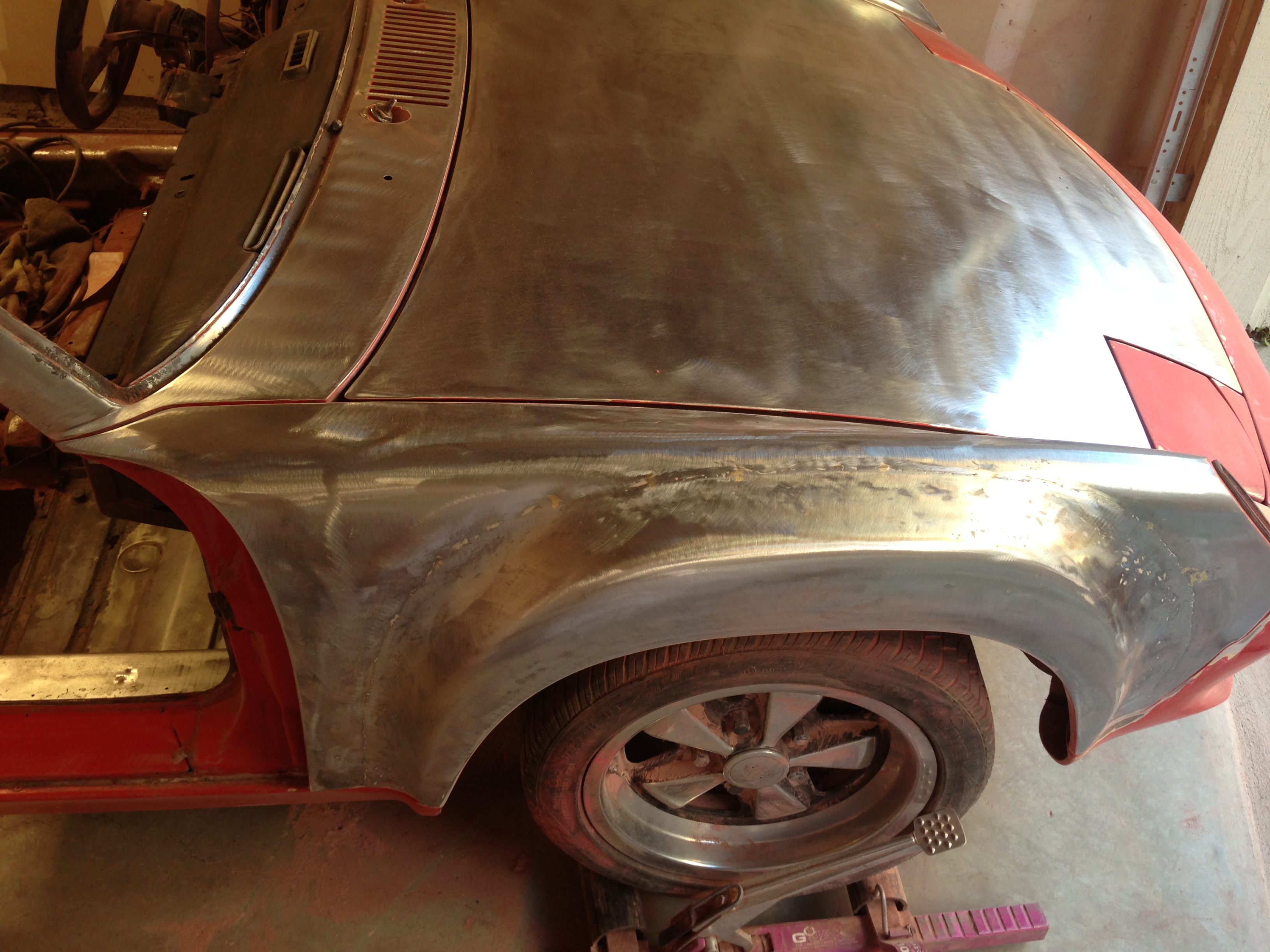

Going to widen the rear flare and repaint looks like a little more work then expected

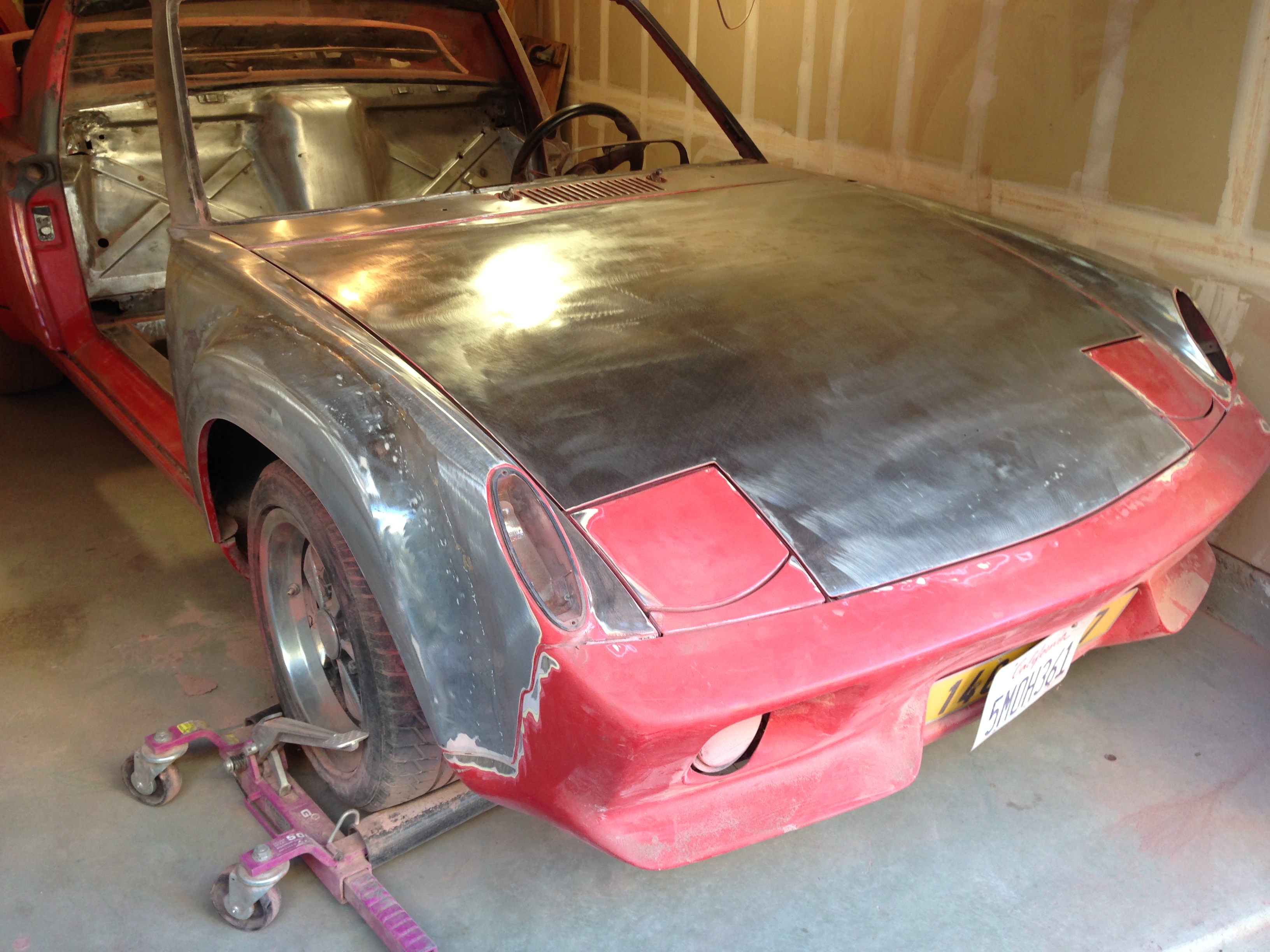

Stripped the good today and the left front 1/4 going to remove the front bumper hopefully have most of it stripped by tomarrow and have it on the rotisserie for the floors hopefully by the end of the next weekend I got my pedal box parts back from the zinc plater and powder coater also ..

Andyrew   The flares look just sub par of a good body tech, ...   Nov 16 2012, 02:47 PM
ONTHEGRIND   Unfortunately I'm not a body guy but I do happ...   Nov 16 2012, 03:04 PM
ONTHEGRIND   Yeah I was just looking for rust gonna hammer and ...   Nov 16 2012, 03:07 PM
boogie_man   That doesn't look too bad at all, weld up and ...   Nov 16 2012, 04:09 PM

Andyrew   Just got to keep at it! I painted Peter's ...   Nov 17 2012, 07:59 AM
ONTHEGRIND   I was thinking about widening the rear flares abou...   Nov 17 2012, 11:30 AM

ONTHEGRIND   Stripped the good today and the left front 1/4 goi...   Nov 24 2012, 05:45 PM

Andyrew   What grit are you using to strip it? Looks like it...   Nov 24 2012, 07:31 PM
ONTHEGRIND   Using 3m green 80 grit 8 Inch disc on a soft pads ...   Nov 25 2012, 11:10 AM
