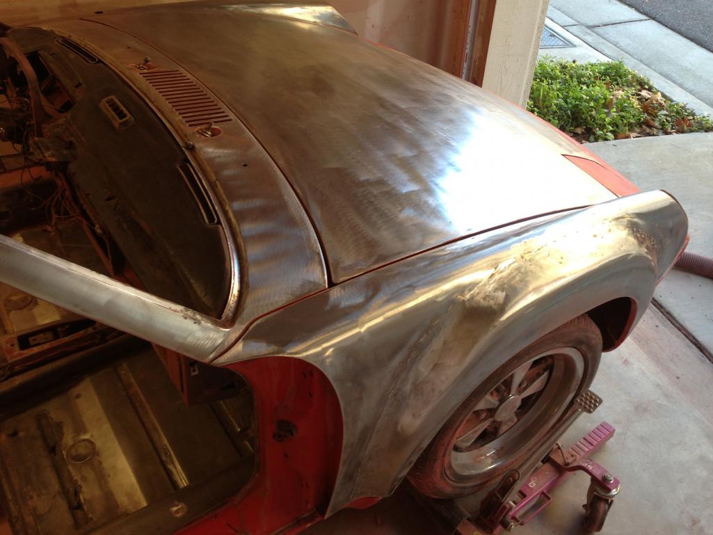

Going to widen the rear flare and repaint looks like a little more work then expected

one more

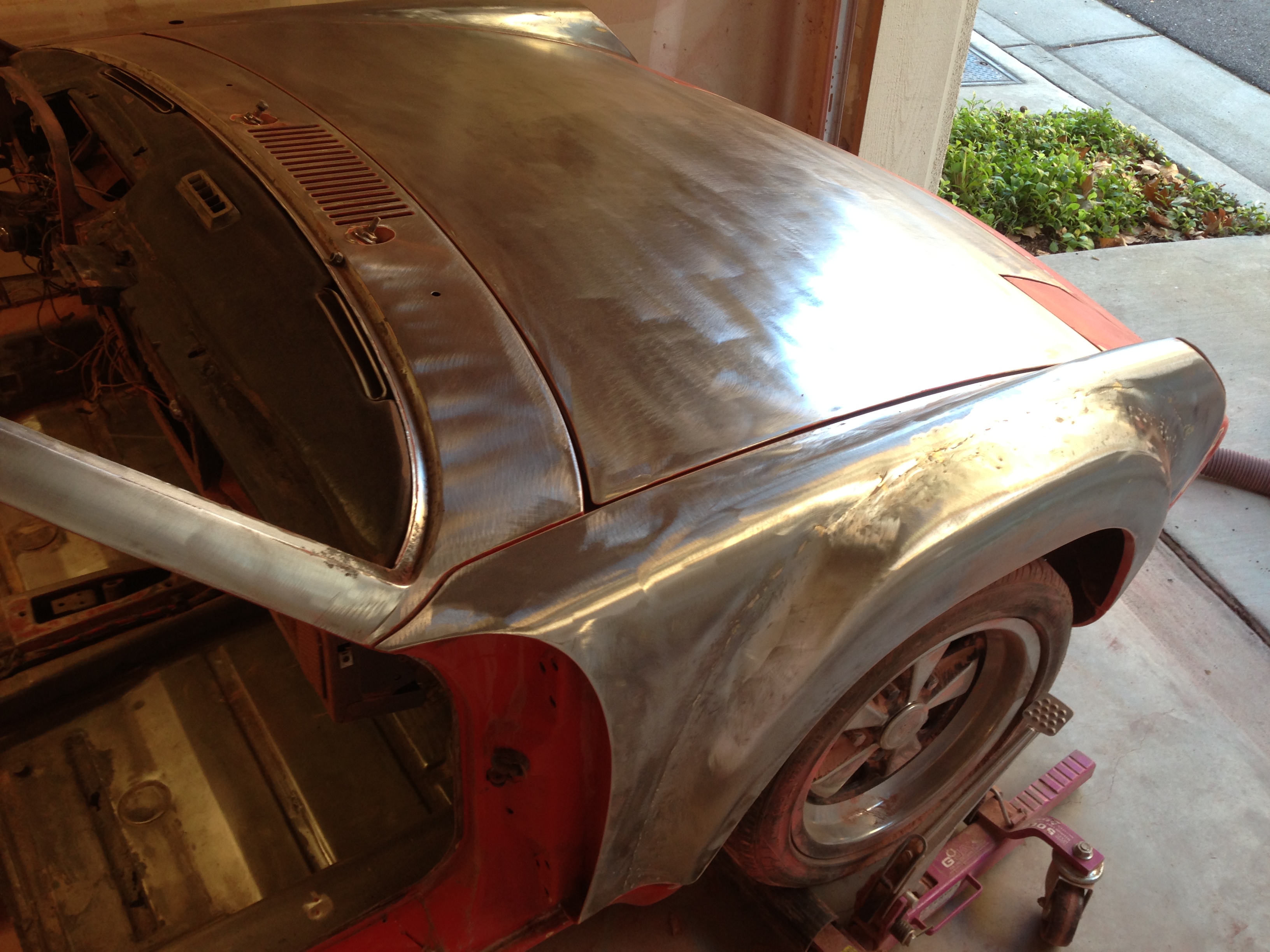

ONTHEGRIND   Stripped the good today and the left front 1/4 goi...   Nov 24 2012, 05:45 PM
ONTHEGRIND   one more   Nov 24 2012, 06:12 PM
Andyrew   What grit are you using to strip it? Looks like it...   Nov 24 2012, 07:31 PM
ONTHEGRIND   Using 3m green 80 grit 8 Inch disc on a soft pads ...   Nov 25 2012, 11:10 AM
