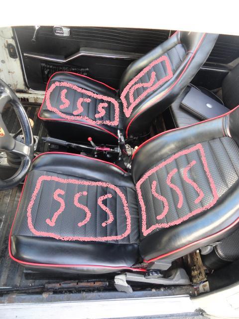

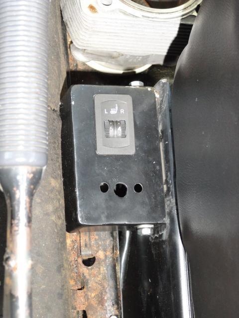

I finally got the opportunity to make a mount for the seat heater switch and the cruise control switch (though I haven’t yet mounted that). I didn’t want it to be visible from the outside and didn’t want to cut big holes in the dash, so I made a 4 sided box and a pair of brackets and mounted it all to the side of the passenger seat mount between the mount and the tunnel. It’s ergonomic for yours truly to reach as I drive and that was a must. I ran most of the wires down the tunnel so they won’t be visible and won’t interfere with carpet later.
So how do the new seat heaters feel??. . . Aaaaahhhhhh, so nice on a cold morning and they have really turned cold as of late which was part of my motivation. It takes about 2 minutes for them to heat-up and then it’s pure heaven with 10 adjustment settings. I can definitely see my lower back getting a therapeutic benefit from this upgrade. New car amenities in an old package; gotta love that combo!! If you’re planning to re-do your front upholstery anyway, these are worth the $80-$100 for the set of elements, the switch and the wiring.
