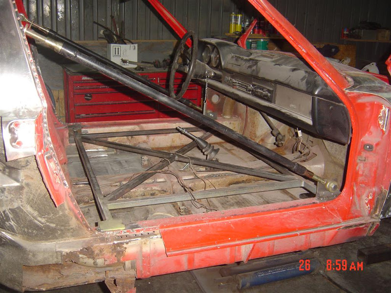

SirAndy   Where is your bracing? :huh: I wouldn't rem...   Nov 26 2012, 12:43 AM
ONTHEGRIND   Was going fab up something at the shop tomarrow I ...   Nov 26 2012, 01:52 AM

ONTHEGRIND   I was looking at door braces last night, I think I...   Nov 26 2012, 09:04 AM
r_towle   well. The front part hangs off a flexible area tha...   Nov 26 2012, 04:19 PM

SirAndy   Any pics ? A simple search for "+floor +br...   Nov 26 2012, 05:09 PM
