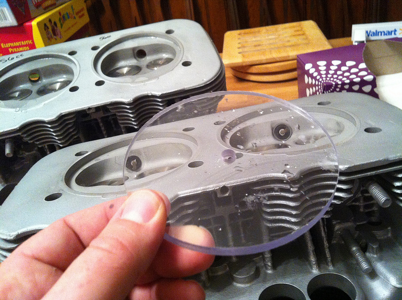

(IMG:http://www.914world.com/bbs2/uploads_offsite/farm9.staticflickr.com-1435-1353980160.1.jpg)
back heads both say 56, which was incorrect... There was a 4CC bubble. I remeasured and they came out at 60 and no bubble.
The plate I cut out of a sheet of 1/4 inch acetate.
Zach

Vacca Rabite   CCed my heads today. Came out to between 60 and 61...   Nov 26 2012, 05:19 PM
Dr Evil   With a deck at 40, you should be fine with 87.   Nov 26 2012, 05:25 PM
