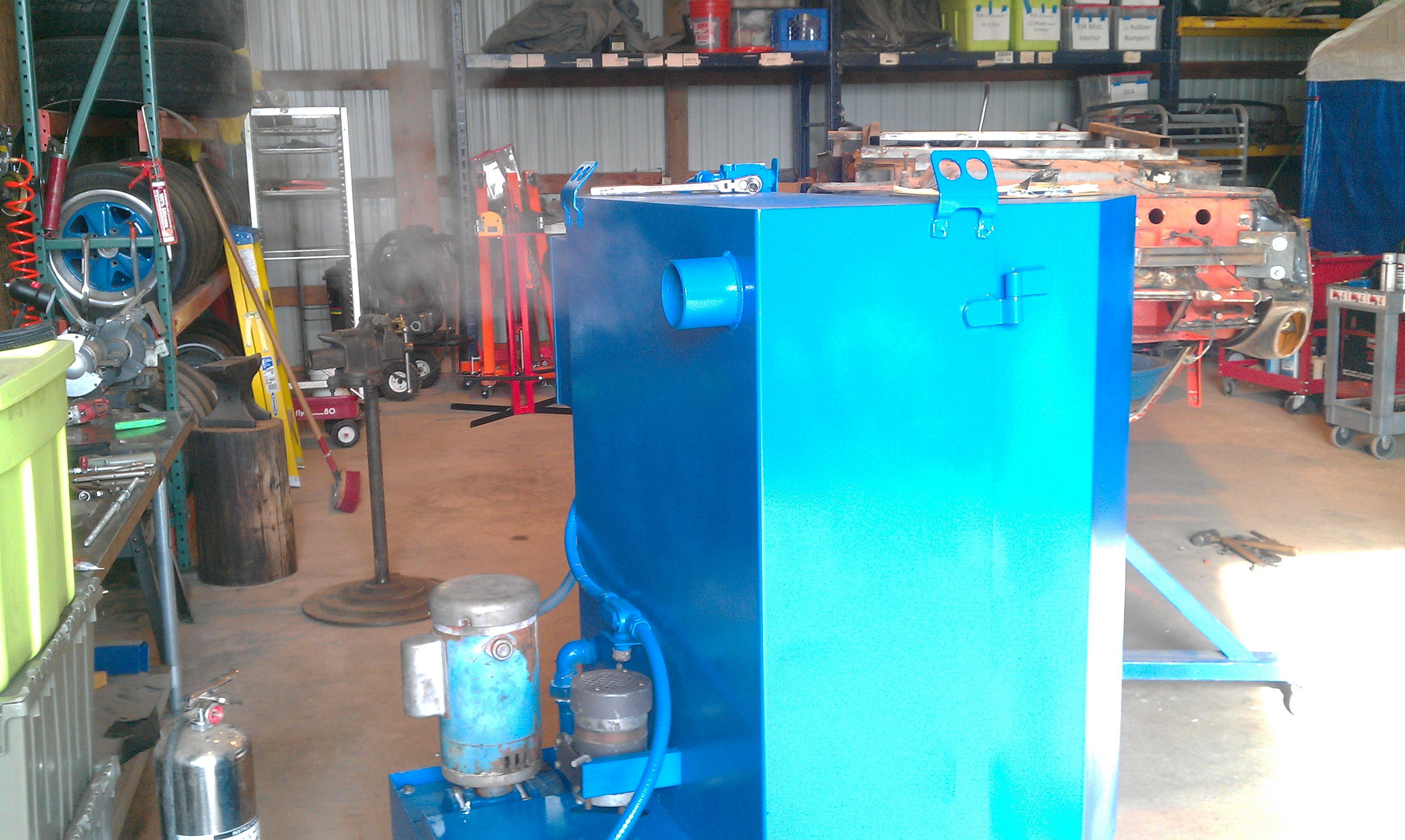

cary   The parts washer lives. Have a small leak at the p...   Nov 26 2012, 11:06 PM
cary   I guess its going to be a Popsicle. White with blu...   Nov 26 2012, 11:23 PM
cary   Well the heater elements work great. The turntable...   Nov 27 2012, 09:16 PM
cary   Steam coming out the vent pipe.   Nov 28 2012, 10:05 PM
