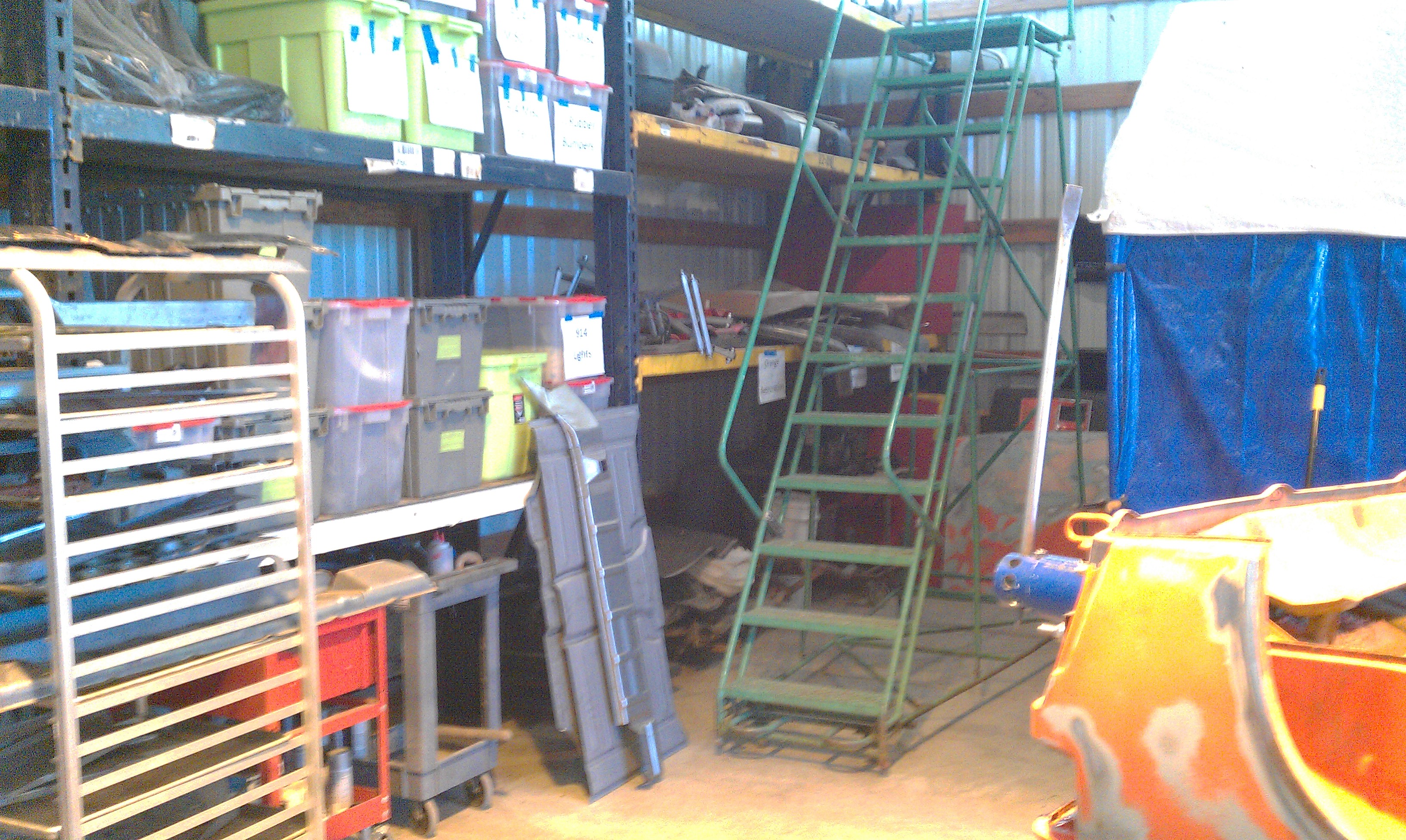

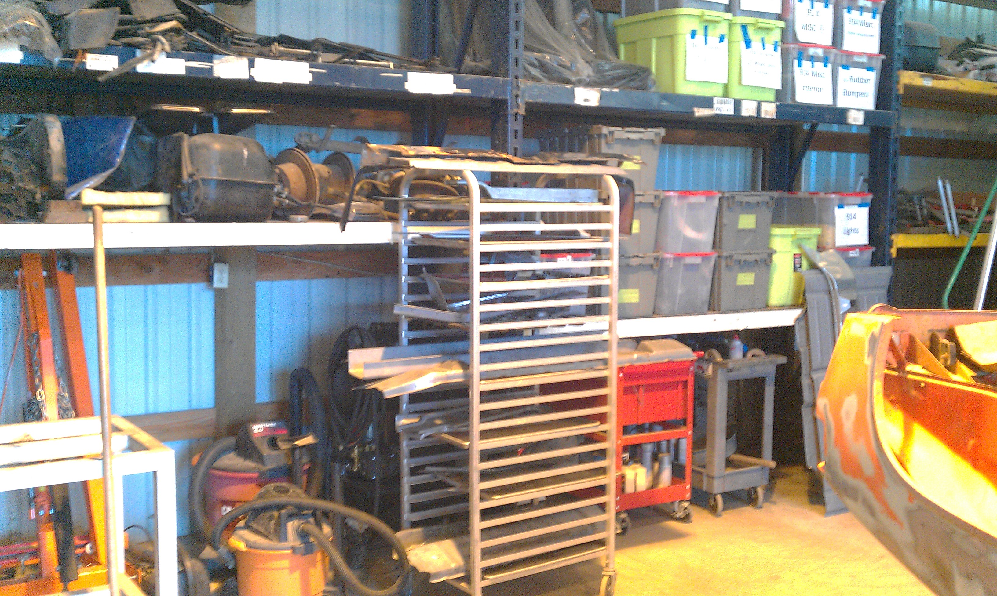

cary   Clean up day at the shop. Hadn't really tidied...   Nov 28 2012, 10:08 PM
