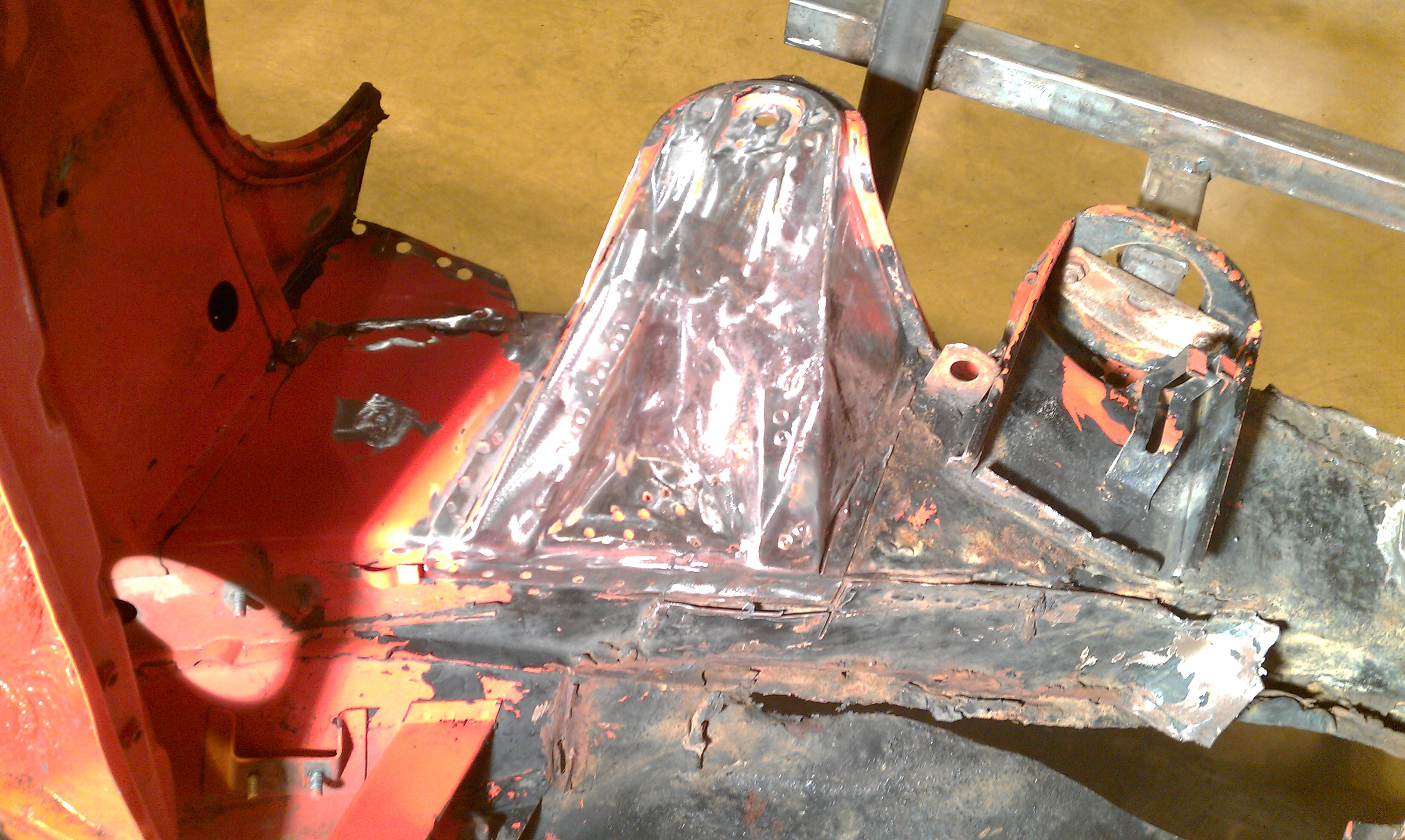

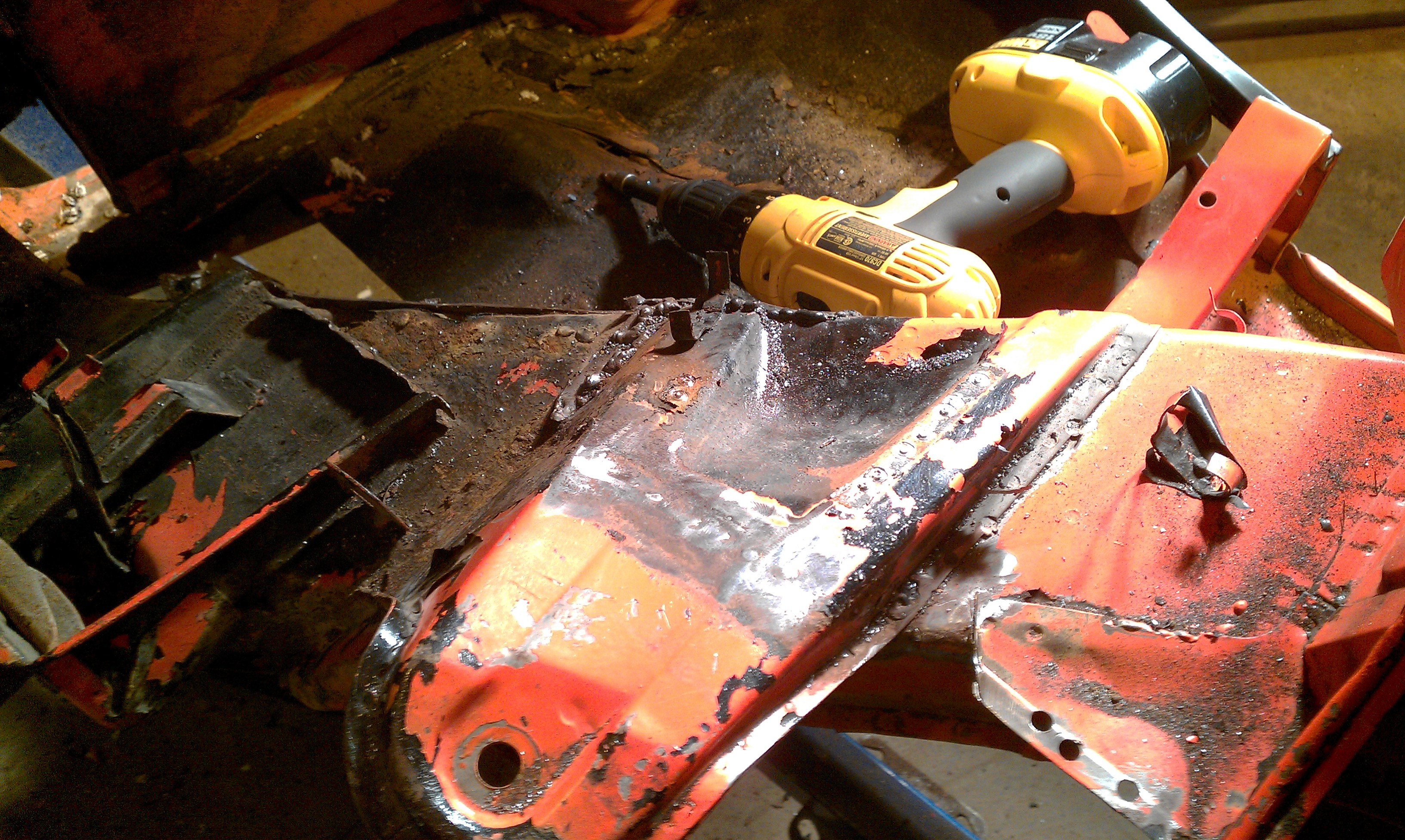

Well getting back to it. Removed the engine tray we fabricated 10 years ago.
Now to get the right suspension console and engine mount ready to remove.
Removed the MPS bracket. That will allow us to get at the upper spot welds on the console.
Console looks to be in pretty good shape. A little pitted where we covered it with patches. (IMG:style_emoticons/default/sad.gif) (IMG:style_emoticons/default/sad.gif)
Can't get into the brake line bracket spot welds. That will have to wait.
The engine mount is going to be tough. Looks like it was removed and seam welded somewhere in its past.
