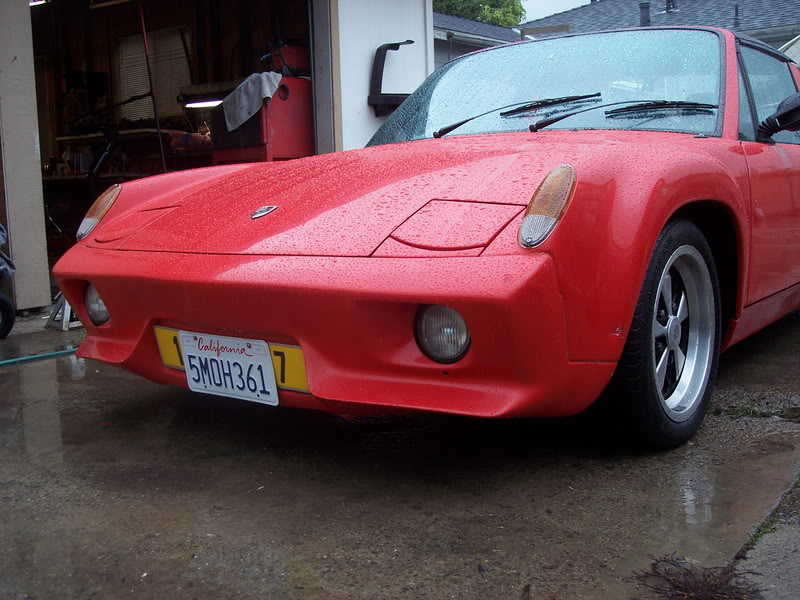

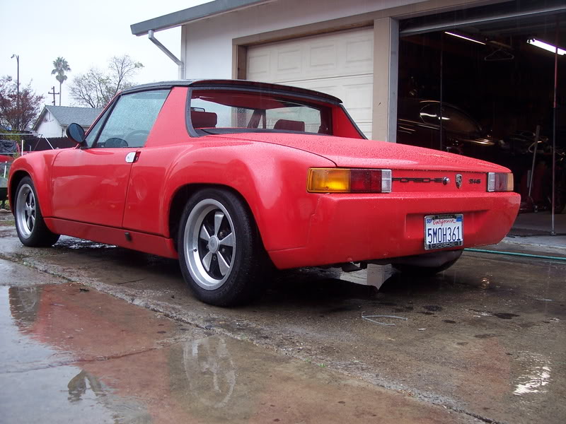

So I haven't been slacking just haven't takin any photos I will update tomarrow here is a pic of the car before and guesses on the color ? Bahia red or gaurds red car is a 71 don't have the code on the door.

QUOTE(ONTHEGRIND @ Dec 1 2012, 12:03 AM) *
Hard to tell with the rain and overcast.
Looks like faded guards red.
Point of reference, SirAndy's avatar shows guards red.
