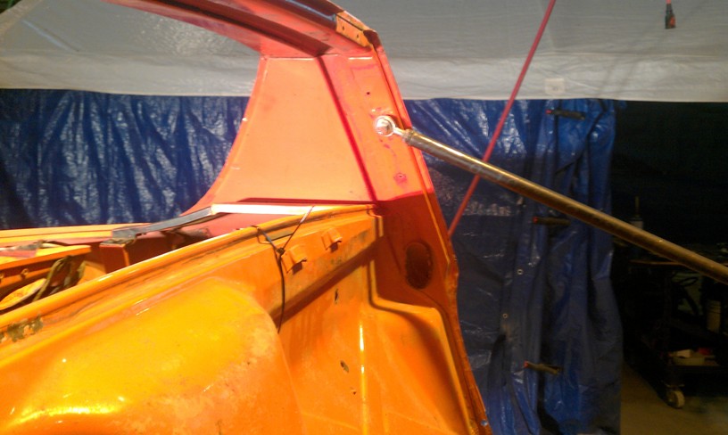

Member No.: 1,608
Installed the new door braces. Complete with Heim joints.
Works like a charm. Much better. Holds the setting, even upside down. (IMG:style_emoticons/default/smile.gif) (IMG:style_emoticons/default/smile.gif)
The 7/16-20 threads work real smooth.

cary   Installed the new door braces. Complete with Heim ...   Dec 3 2012, 11:09 PM
cary   With the new braces installed and dialed in. The f...   Dec 3 2012, 11:35 PM
