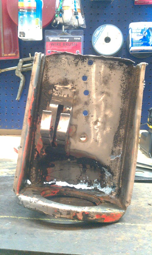

With the new braces installed and dialed in.
The frame jig was removed so I could get at the engine and suspension console.
Off came the engine console.
As you can see it has some extra ventilation. (IMG:style_emoticons/default/sad.gif) (IMG:style_emoticons/default/sad.gif)
Another manufacturing error. Why didn't they seam seal the top?
You should have seen the debri that came out from behind that thing.
I guess its official name is, engine mounting.
I'm thinking that's it's repairable? I think I saw Mark rebuild one.
