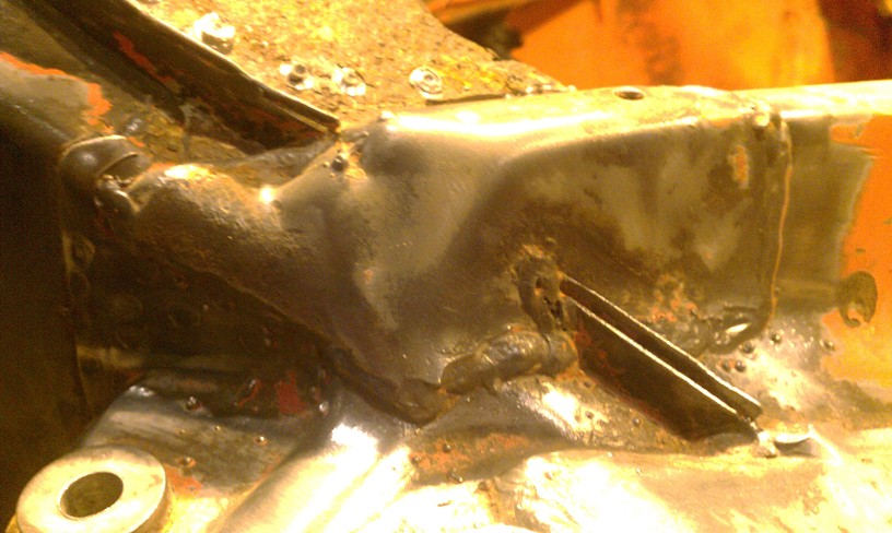

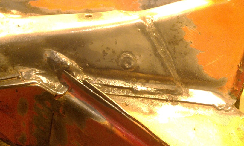

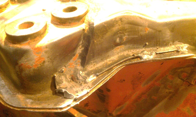

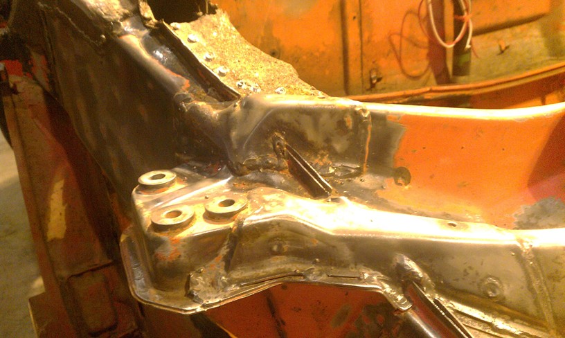

cary   Next is the removal of the suspension console. Can...   Dec 3 2012, 11:41 PM
cary   I also chiseled off the seam sealer on the outer f...   Dec 3 2012, 11:54 PM
