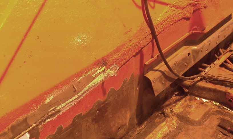

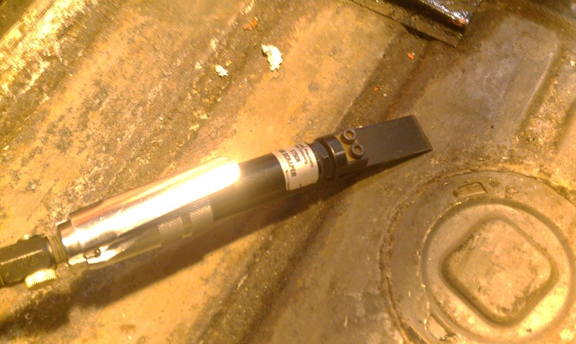

I also chiseled off the seam sealer on the outer fire wall seam in about 15 minutes.
This was all done with the air chisel. A tool that Jeff Hail turned me on too.
First words of wisdom. 1. Don't cover up the vent hole with your thumb. Kills the pressure. 2. When you hear the tone change. Stop, you've hit a weld.
