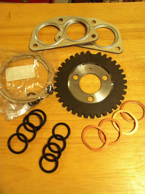

Got a small box from Mark today!!!
(IMG:http://www.914world.com/bbs2/uploads_offsite/farm9.staticflickr.com-1435-1355192690.1.jpg)
Its not everything, but it will get me back working this Friday after I get the kids to bed. I'm now one sensor away from being able to get the engine back in tins!
Let me just say that this trigger wheel is a really WELL made part. I expected goodness, and my expectations were exceeded. Looking forward on getting it bolted on to the crank!
Zach
