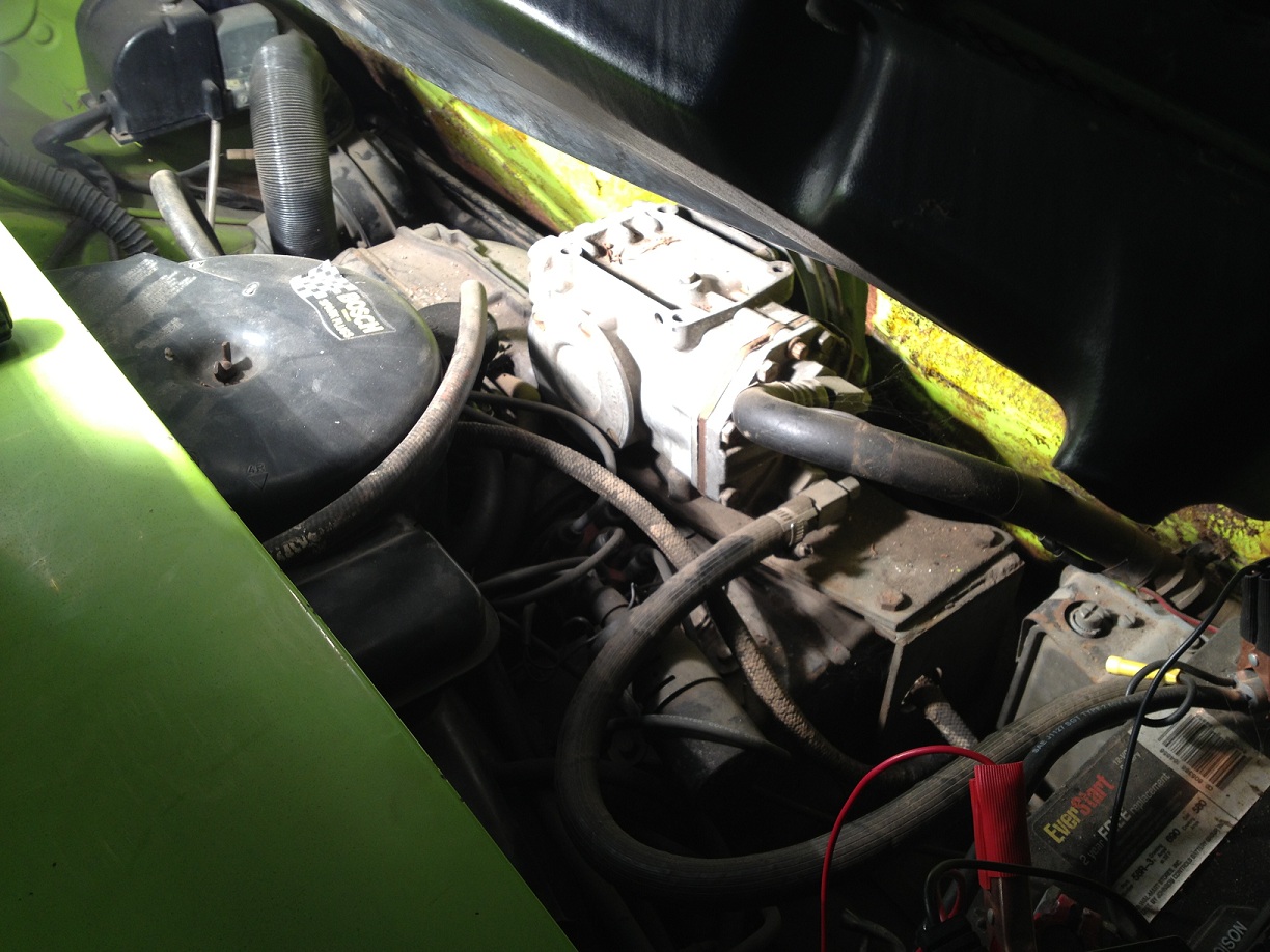

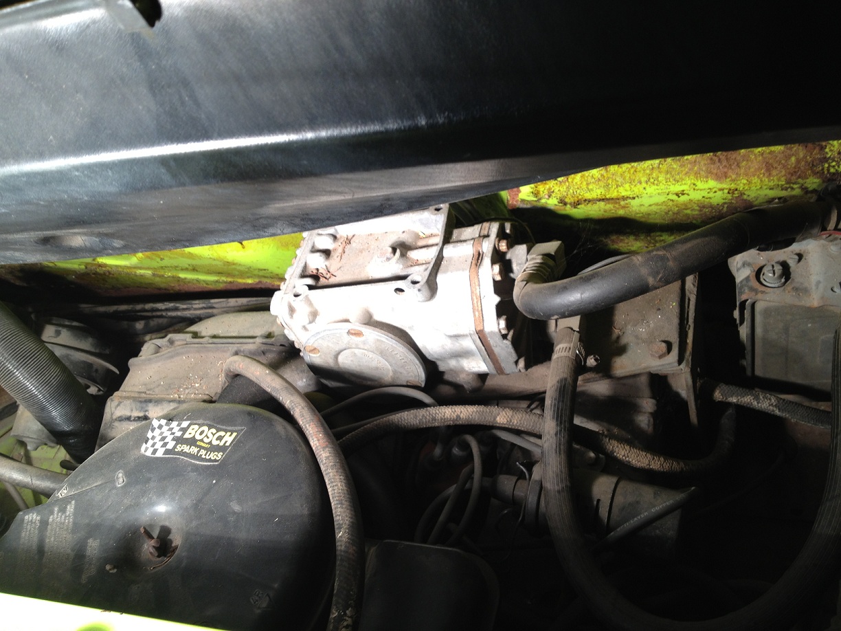

Finally got to the car last weekend and snapped some pics of the compressor on my '73. It also looks like once the bolts are undone (I counted 4), that it would actually have enough hose length to be able to rest it on the rear deck lid. Planning on dropping the engine soon and was worried about suspending it, but seems like it'll sit up there nicely during the drop.
