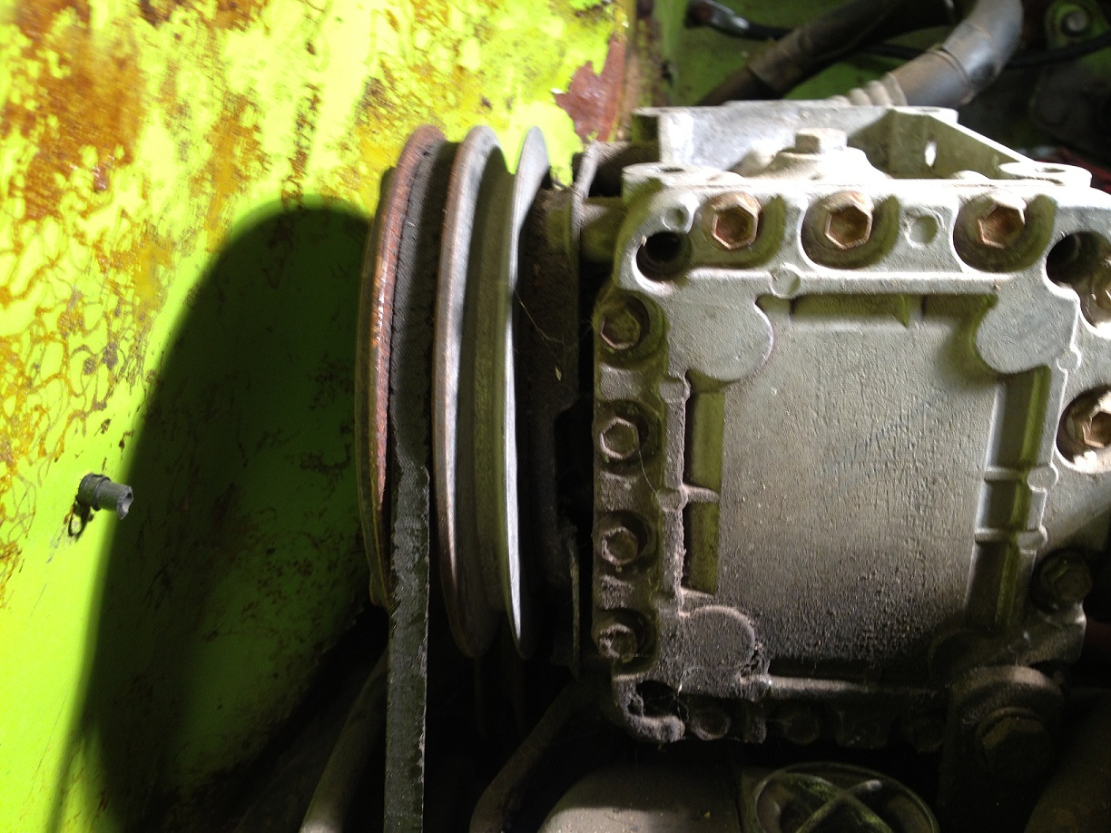

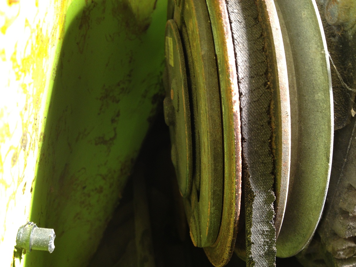

stateofidleness
post Dec 16 2012, 07:49 PM
Posts: 810
Joined: 1-September 07
From: Canyon Lake, Texas!
Member No.: 8,065
Couple more... left them a little bigger because it's hard to find large reference images for stuff like this:

stateofidleness   K guys, I wanted to dig in a little more on this b...   Dec 16 2012, 07:39 PM
stateofidleness   Couple more... left them a little bigger because i...   Dec 16 2012, 07:49 PM
stateofidleness   Uno Mas. Markings on the visible side of the compr...   Dec 16 2012, 07:51 PM
stateofidleness   Couple more reference pics as I finished getting t...   Dec 28 2012, 03:35 PM
