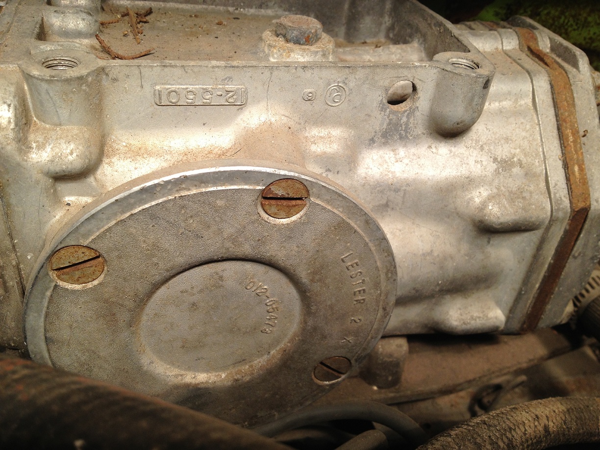

Uno Mas. Markings on the visible side of the compressor (opposite the pulley):

stateofidleness   Uno Mas. Markings on the visible side of the compr...   Dec 16 2012, 07:51 PM
