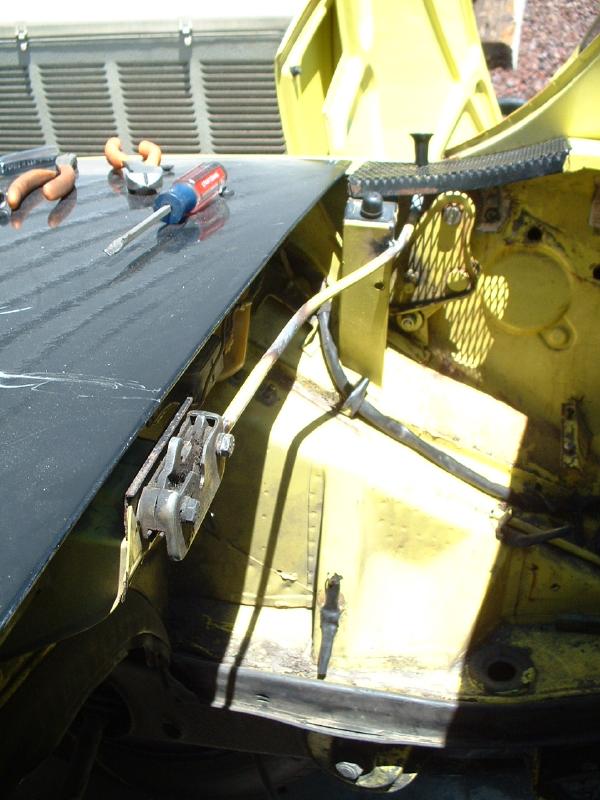

Been slaving away at it... yesterday was fixing the rear end damage and installing the flare. Today was weld in the rear hood pivot, weld the engine lid hinge, weld in the rear sway bar mounts, install hoods and lid and... build and weld/install a GT engine latch.
The GT engine latch was easier than expected. I pulled the cable and cut the tube down by the first weld. I heated it and bent it the way I needed it. Rewelded it back to the latch area and welded it to the outer grill area. I refit the cable and cut it to the new length. I have a VW gas latch pull on order (that's what the GT used).
