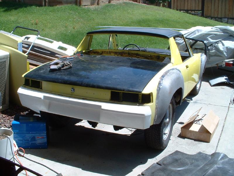

Hoods on...

Eric_Shea   Been slaving away at it... yesterday was fixing th...   Jun 18 2004, 07:13 PM
Eric_Shea   nuther shot...   Jun 18 2004, 07:14 PM
Eric_Shea   GT lid on...   Jun 18 2004, 07:16 PM
Eric_Shea   Hoods on...   Jun 18 2004, 07:18 PM
Brad Roberts   Your backyard looks like a 914 monster shit in it....   Jun 18 2004, 07:19 PM
Eric_Shea   Quit your job... :D Worked for me! :beer1:   Jun 18 2004, 07:22 PM
