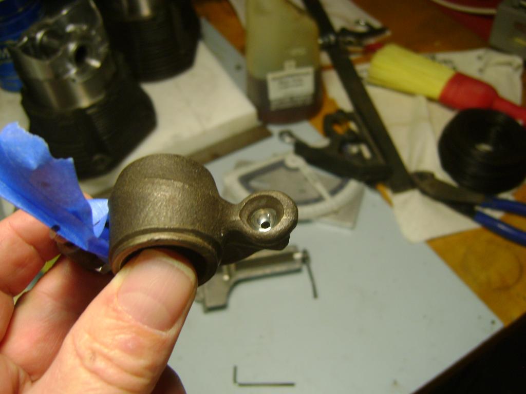

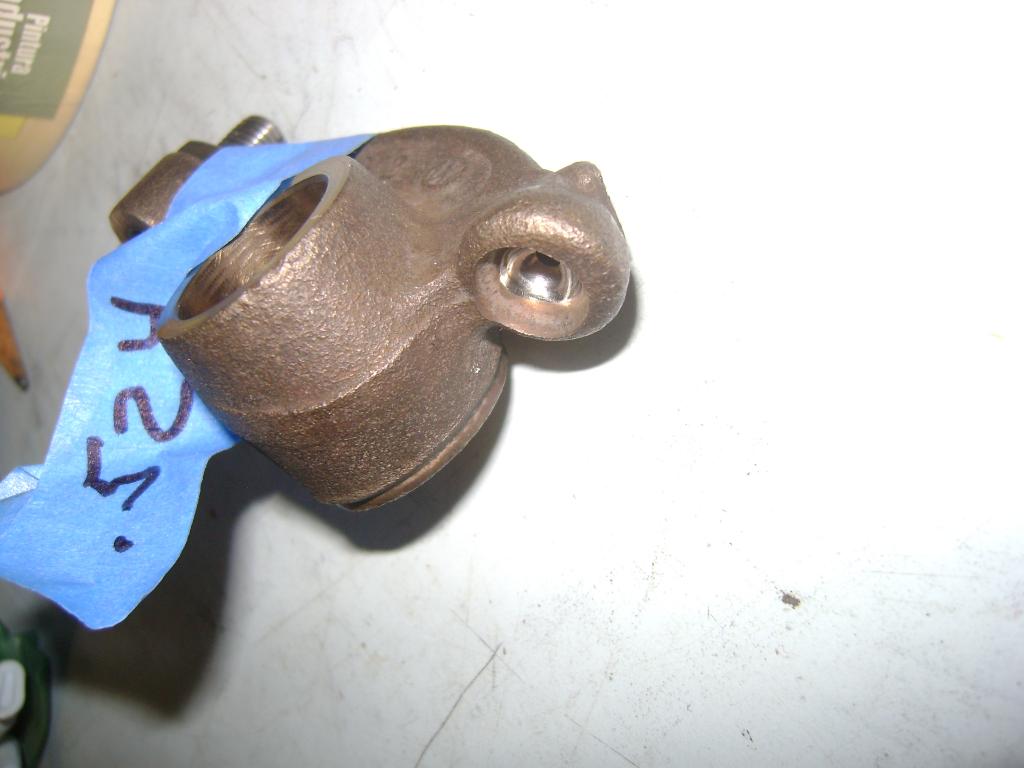

Racer Chris,
I measured all 4 of them, Valve lift was: .546, .524, .524, 532.
For a ratio of: 1.42, 1.36, 1.36, 1.39
Here are pics of the pushrod seats as you requested.
(IMG:http://www.914world.com/bbs2/uploads_offsite/i366.photobucket.com-10819-1356214173.1.jpg)
(IMG:http://www.914world.com/bbs2/uploads_offsite/i366.photobucket.com-10819-1356214173.2.jpg)
If you are still interested in trading for a set that are closer to 1.3, I would be willing.
These HAVE been modified for the swivel feet (.060 removed from face & lightly countersunk).
Stu
