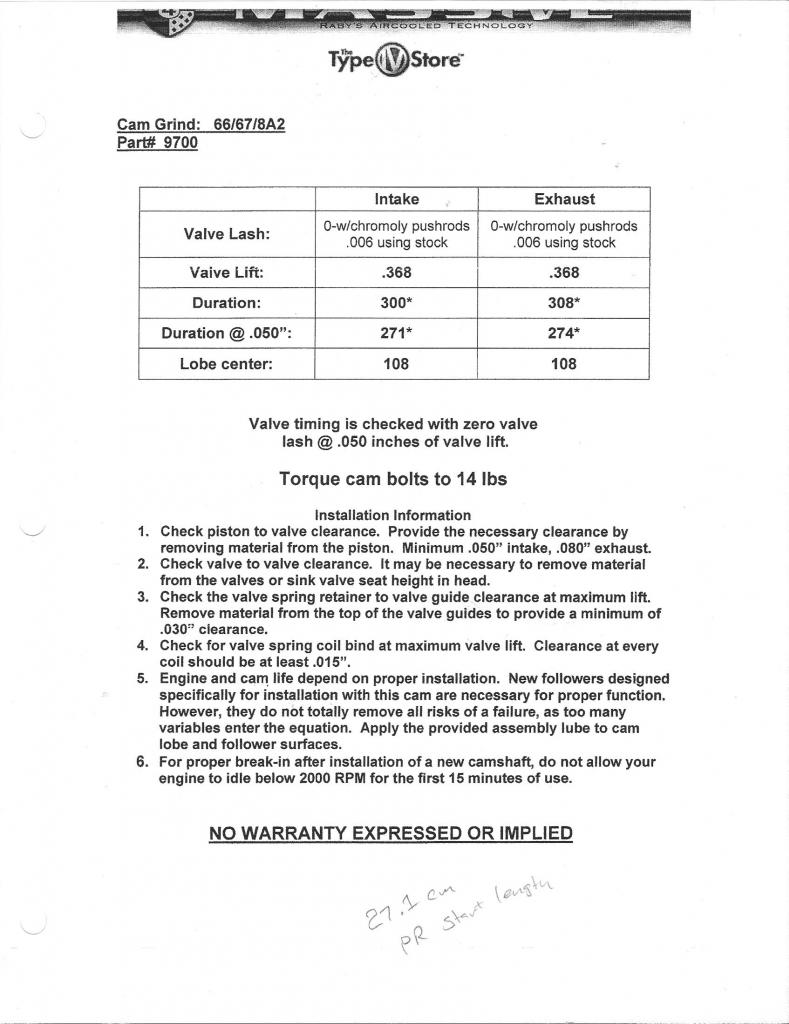

I will get pics of the test rig after dinner, but here is the "cam card" that I got from Jake:
(IMG:http://www.914world.com/bbs2/uploads_offsite/i366.photobucket.com-10819-1355965443.1.jpg)
So I guess I am "off my meds"...?
So if I follow Jake's EXACT wording from his valve geometry adjustment, I need to set my valve lift to .368. I'll get right on that (IMG:style_emoticons/default/confused24.gif)
I am currently in the "check valve to piston clearance" step (step 1) and I have 0.73 from the intake valve to the piston (when I plan on removing 0.050 from the heads), but I guess I just "have issues"
I'm done...peace out. (IMG:style_emoticons/default/wacko.gif)
And BTW - I fully profiled the cam myself, and those numbers up there with the asteriks (*) must mean - "or somewhere around that"....
The only number I got that matches is the lift and I measure 0.388 when the card says .368, but I did not have full spring pressure on the lifter, so close enough for now.
Stu

QUOTE(stugray @ Dec 19 2012, 05:04 PM) *
Those are duration numbers, and the * should be a °.
