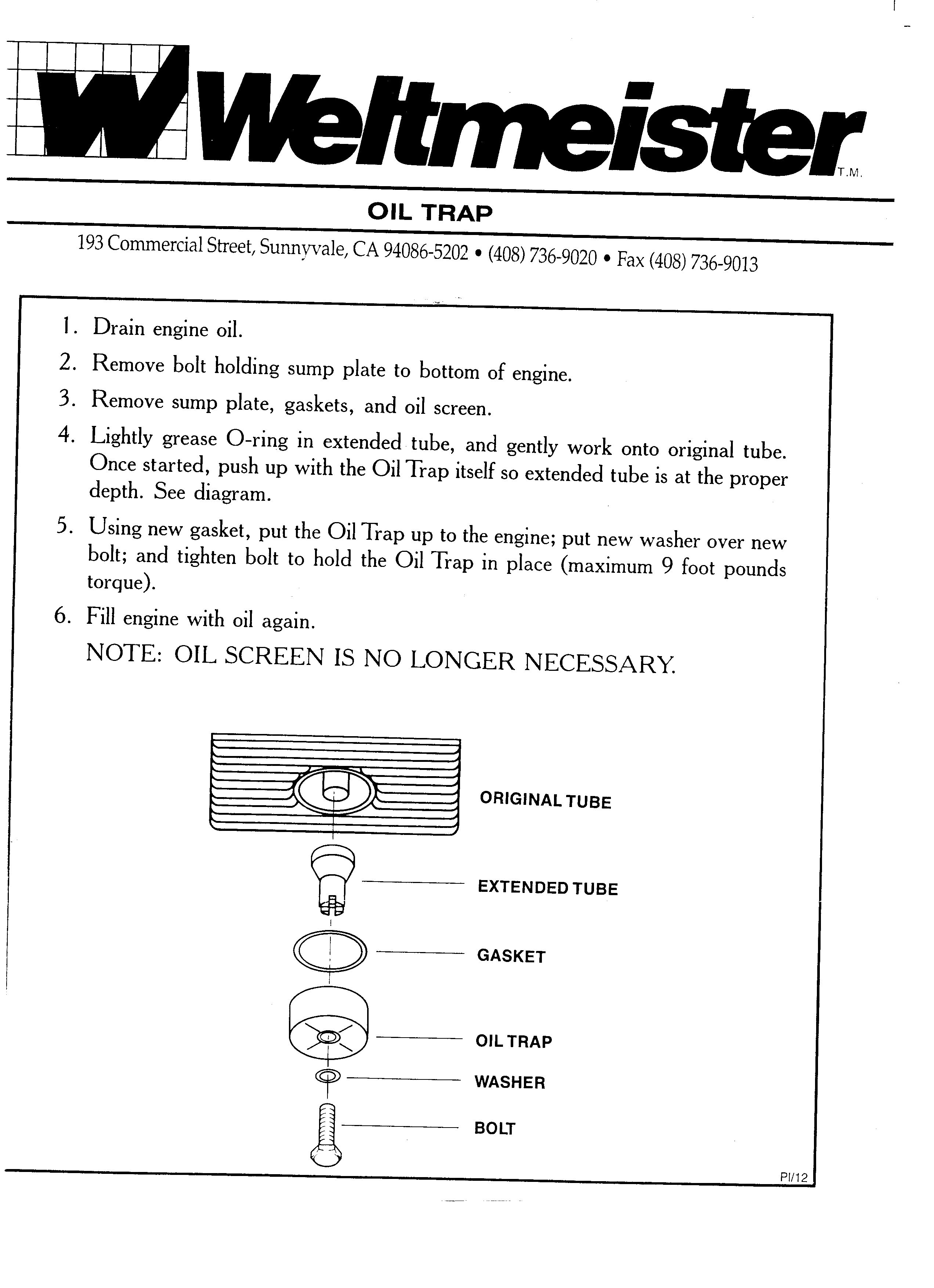

I recently picked up a 'previously owned' steel tuna can, but all I got was the can and bolt. Does anyone have a copy of the installation instructions or info on extending the pick-up tube, gaskets or seals needed ... and can tell me if the strainer relocates down to the bottom of the 'can'? (IMG:style_emoticons/default/confused24.gif)

Here is a photo of a new/un-installed Weltmeister "tuna-can" kit with
the original instructions.
--- bill
Instructions: Attached File  TunaCan.pdf ( 66.06k ) Number of downloads: 346
Instructions: (jpeg)

The opinion from someone who has built performance type one's forever... the pick-up on the tuna can is a real super crap design. (IMG:style_emoticons/default/WTF.gif)
I'd like to see how the jonesy one goes together. (IMG:style_emoticons/default/confused24.gif)

Dave_Darling   The pickup tube extension is, from what I can tell...   Aug 28 2012, 11:43 AM

markb   Hmmm, with the exception of the seals, I thought I...   Aug 28 2012, 10:44 PM
euro911   The aluminum piece (pick-up the extension) shown i...   Aug 29 2012, 12:17 AM

ejm   The "washer" is a stock strainer plate s...   Aug 29 2012, 04:27 AM

last337   I am trying to figure out what the purpose of this...   Dec 28 2012, 01:20 PM
ChrisNPDrider   Purpose of tuna can: provide reliable "input...   Dec 28 2012, 02:06 PM
Dave_Darling   It adds something on the order of a half quart of ...   Dec 29 2012, 01:11 AM
gothspeed   Does the siphon tube extension on this kit have a ...   Dec 29 2012, 12:07 PM
euro911   Does the siphon tube extension on this kit have a ...   Dec 29 2012, 01:49 PM

RobW   Don't over torque it!   Jan 3 2013, 09:05 PM
