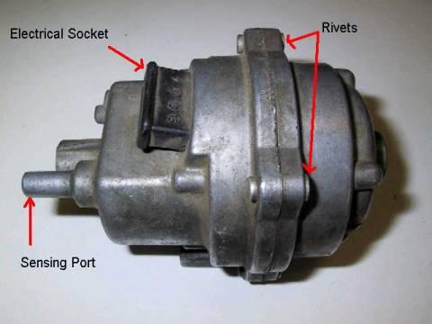

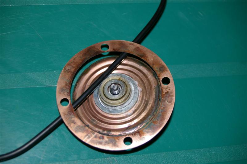

on the passenger side of the engine compartment - it has a vac hose attached ,
manifold pressure sensor- they fail eventually , either leaking due to lost seal, or the copper plate in side tears.

QUOTE(Philip W. @ Jan 3 2013, 12:25 PM) *
Aha! I'll take a look at that too. the wiring harness for that has a rectangular tombstone shape, with two adjacent corners rounded but the sensor itself has a socket with all 90 degree corners and the plug can be inserted in either direction. So...while I was trying both directions the entire plug body slipped off the four wires. Do you know what wire goes in which position? (IMG:style_emoticons/default/sad.gif)
