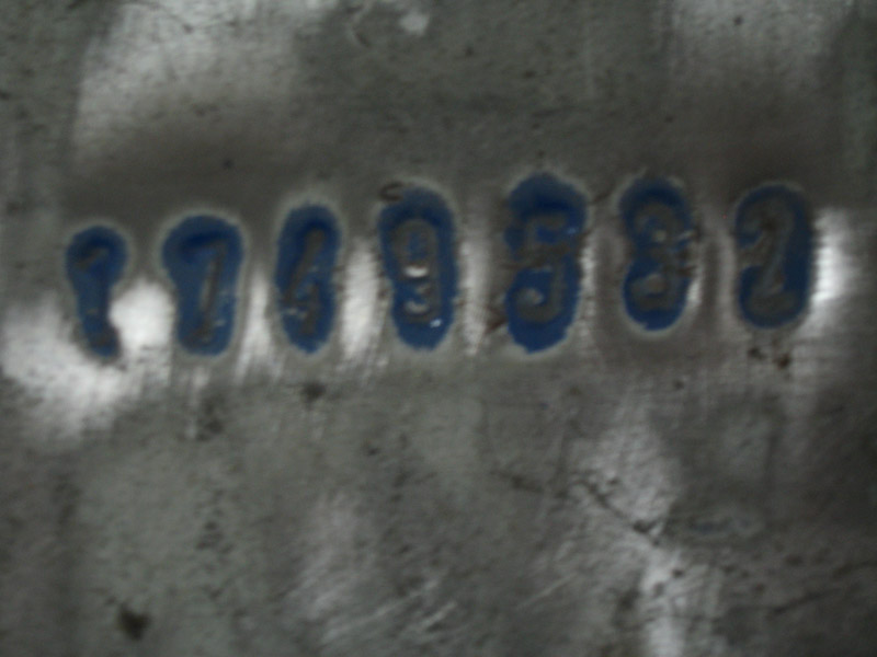

I was looking back through this, contemplating whether my dash is original or not, and an anomilie has come to me. (IMG:style_emoticons/default/biggrin.gif)
As above, this is the stamp in the trunk of my car
(IMG:http://www.914world.com/bbs2/uploads/post-11782-1340848499.jpg)
1749532

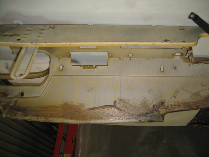

and this is my dash from the same car
(IMG:http://www.914world.com/bbs2/uploads/post-11782-1340848480.jpg)
1729556

So if you look at the numbers, they are both from the same week 17. The odd thing is that the car then has a '4', the dash a '2' (Thursday and Tuesday respectively). The thing is that the number from Tuesday is higher than the number on Thursday, and it's supposed to be cumulative for the week?
The one solution I can think of is maybe the dash is from a different year entirely - would there be any way to tell?
