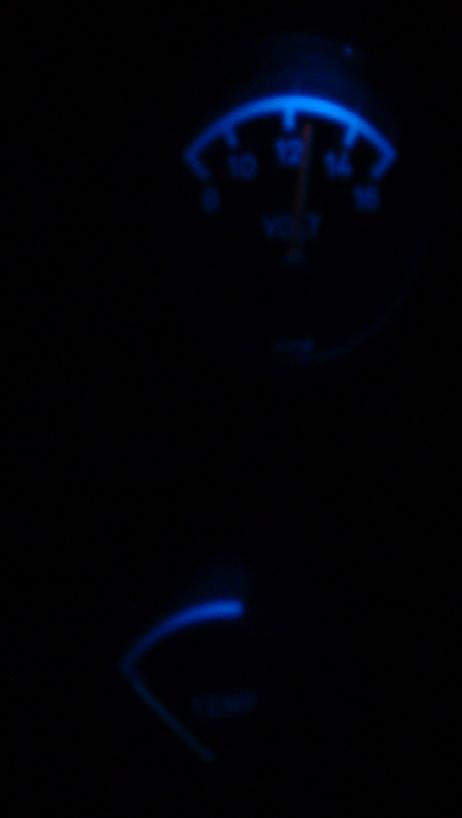

Just thought I'd post some pix of an experiment I did with some 10,000 MCD Blue LEDs. I got them on ebay from a guy in Hong Kong. No problem w/ shipping. You are looking at a temp gauge and a voltage gauge. There are 3 leds per gauge.
Just use a 330 ohm(*1/2 watt) resistor per ea. easy to get, easy to solder. Use shrink tubing to keep them from shorting.
*These LEDS use 423mW @ 12v...3 of them use 1.3w... The stock bulbs use 2w so there is no need to worry about the fuses.

balthazar   Hi! Just thought I'd post some pix of an ...   Jun 21 2004, 08:28 PM
balthazar   Here is another picture...They are plenty bright e...   Jun 21 2004, 08:31 PM
