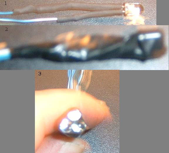

I used regular phone wire.
(1)Once the soldering is done, put on shrink tubing
(2)3 leds taped together with elecrical tape
(3)front view
Just replace bulb holder with this. Add tape as needed to wedge into the hole. You can twist together the ends, solder, then crimp onto stay cons so you can use existing wiring...
