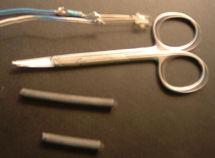

Here's how it looks without the shrink tubing...

balthazar   Hi! Just thought I'd post some pix of an ...   Jun 21 2004, 08:28 PM
balthazar   Here is another picture...They are plenty bright e...   Jun 21 2004, 08:31 PM
balthazar   I used regular phone wire. (1)Once the soldering...   Jun 21 2004, 08:57 PM
balthazar   Here's how it looks without the shrink tubing....   Jun 21 2004, 08:59 PM
