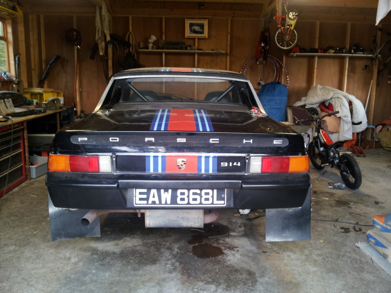

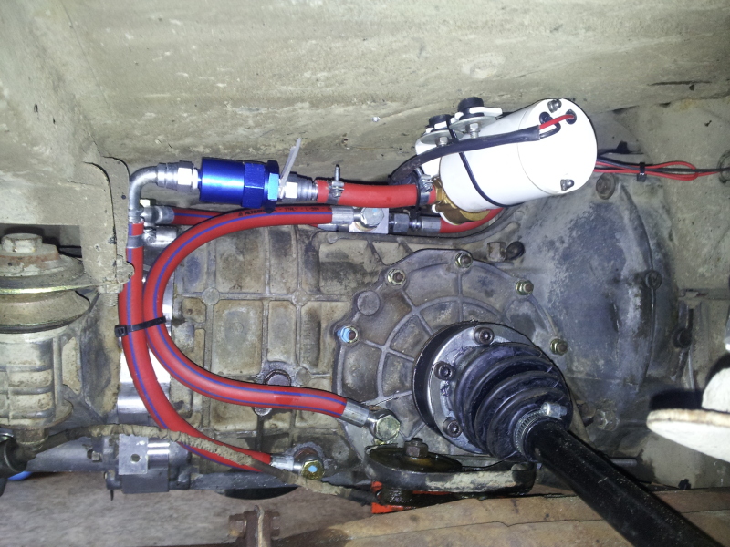

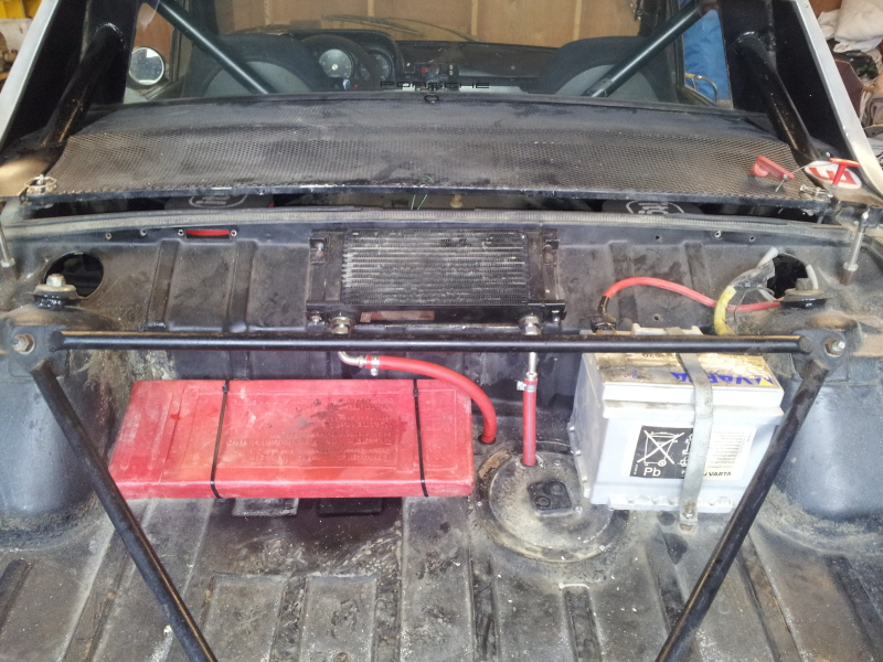

Here's some updated pics of my install all finished:
