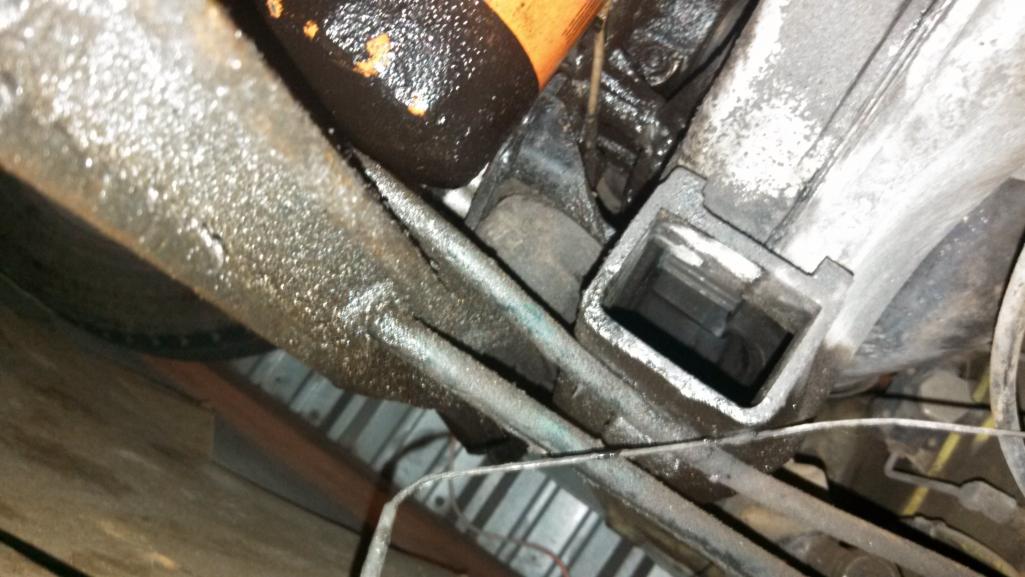

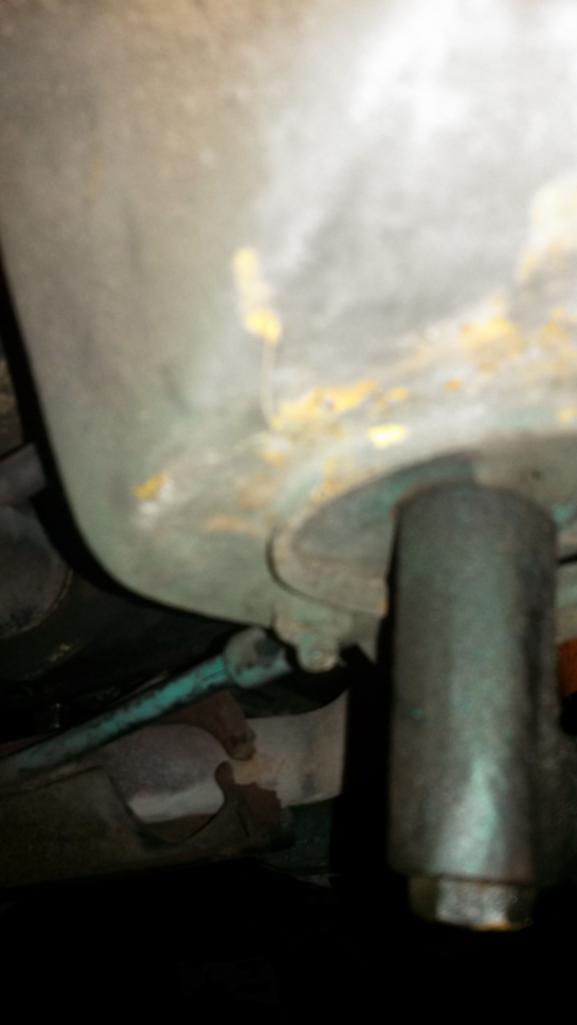

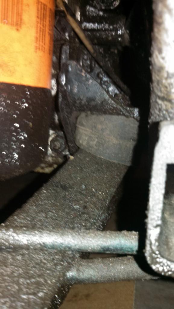

Hey guys I need some advice. My engine bar is bent backwards towards the rear of the car. The bar itself looks fine, but the two bolts are angled about 60 degrees instead of 90. My shift linkage is rubbing but isn't causing any problems.
My question is... Should I use a big pry bar and bent it back to vertical or do I need to drop the bar and do something at the mount area? I don't want to weaken the bolts or the mounts more. Are the mounts rubber and they just need to be re seated?
Thanks for any help

Well upon closer inspection it appears To be the end bolts that go into the frame that are bent. Actually the engine mounts look okay for now. Hopefully won't be too hard to fix
