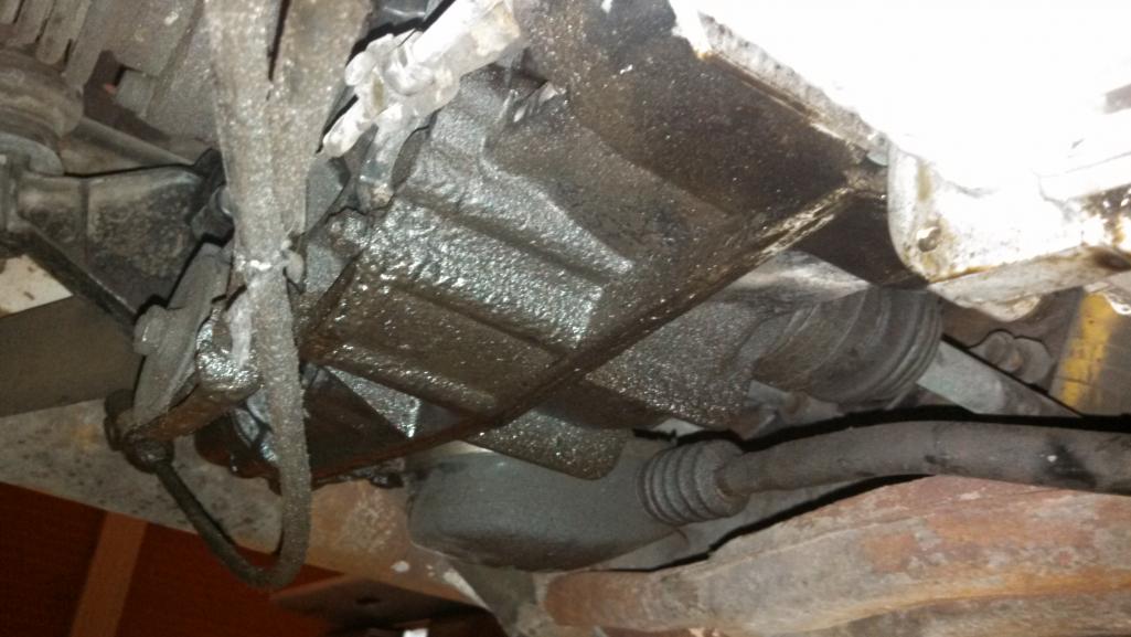

I have a '73 2.0 so I guess that means it is a sideshift.

QUOTE(last337 @ Jan 14 2013, 11:19 AM) *
Typically, yes. I have a '75 that a DF/PO stuck a tail shift trans in (IMG:style_emoticons/default/dry.gif) ... but that's something you don't run across too often.

Oh and here is a pic of transmission. I guess this is side shift seeing as how its on side. What does a tail shifter look like?
