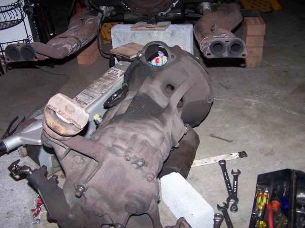

Hey guys I need some advice. My engine bar is bent backwards towards the rear of the car. The bar itself looks fine, but the two bolts are angled about 60 degrees instead of 90. My shift linkage is rubbing but isn't causing any problems.
My question is... Should I use a big pry bar and bent it back to vertical or do I need to drop the bar and do something at the mount area? I don't want to weaken the bolts or the mounts more. Are the mounts rubber and they just need to be re seated?
Thanks for any help

reharvey   The brackets the bolts go though may also be bent.   Jan 13 2013, 04:09 PM
stugray   We need to know what year. The motor mounts are di...   Jan 13 2013, 04:28 PM
last337   I have the exact same problem and have been thinki...   Jan 13 2013, 04:45 PM
reharvey   I have the exact same problem and have been think...   Jan 13 2013, 06:06 PM
Spoke   I recently had to remove the engine bar to do some...   Jan 13 2013, 06:54 PM
last337   I recently had to remove the engine bar to do som...   Jan 13 2013, 07:00 PM
ottox914   Better pics would help. Sounds like you are on th...   Jan 13 2013, 07:23 PM
Dave_Darling   The big bolts are already eff'ed, so go ahead ...   Jan 13 2013, 09:35 PM
Valy   I have a good engine bar for you for free. Just co...   Jan 13 2013, 10:31 PM
McMark   Best way to completely remedy this issue: 1. supp...   Jan 14 2013, 12:13 PM
euro911   It would take a lot to bend a cast iron engine bar...   Jan 14 2013, 12:35 PM
last337   It would take a lot to bend a cast iron engine ba...   Jan 14 2013, 12:58 PM
JawjaPorsche   It would take a lot to bend a cast iron engine b...   Jan 14 2013, 01:15 PM
last337   I have a '73 2.0 so I guess that means it is a...   Jan 14 2013, 01:19 PM
JawjaPorsche   I have a '73 2.0 so I guess that means it is ...   Jan 14 2013, 01:22 PM
last337   I have a '73 2.0 so I guess that means it is...   Jan 14 2013, 02:15 PM
euro911   I have a '73 2.0 so I guess that means it is a...   Jan 14 2013, 07:18 PM
last337   I have a '73 2.0 so I guess that means it is ...   Jan 14 2013, 07:29 PM
McMark   That's what I thought. But I had one that wa...   Jan 14 2013, 05:26 PM
The Cabinetmaker   I've seen this on lots of cars. It's almos...   Jan 14 2013, 05:27 PM
last337   Well upon closer inspection it appears To be the e...   Jan 14 2013, 07:24 PM
