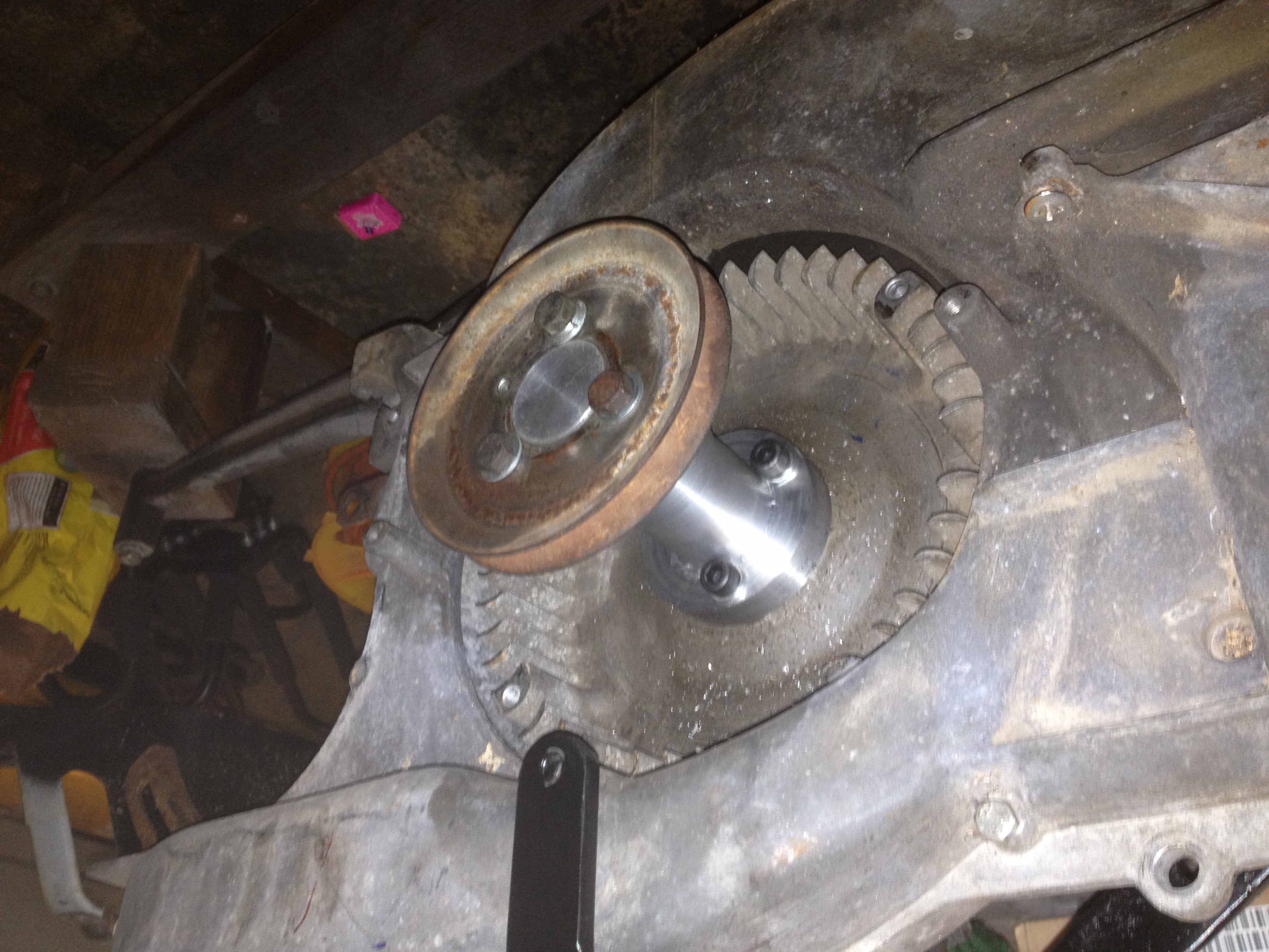

Not a big update but I did finish the pulley adapter. Now I just need to install everything one of these days and start testing it.

dlee6204   I made some progress on my A/C pulley. As I state...   Nov 25 2012, 04:12 PM

dlee6204   Not a big update but I did finish the pulley adapt...   Jan 24 2013, 07:51 PM
