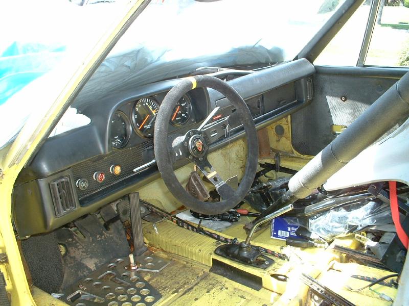

Got the dash and various pieces in yesterday... just got my DSL back up.
I'm going to call this Mother Hubbard's "Tubbard". I'm glad I have this other 74 here to steal from. Bradhole picked it CLEAN!! (IMG:style_emoticons/default/w00t.gif)
Waiting for some missing pieces to get the Rich-6 Mount finished. I may swap the suspension today.
Still need to pull out the front end a bit more and get the drivers front fender on.
