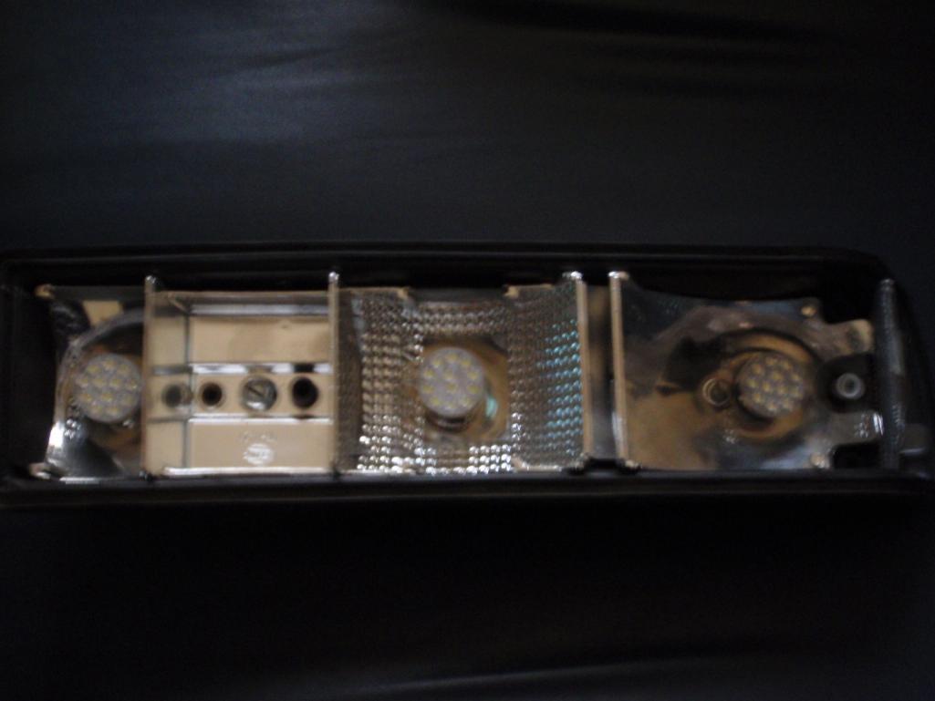

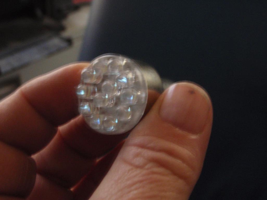

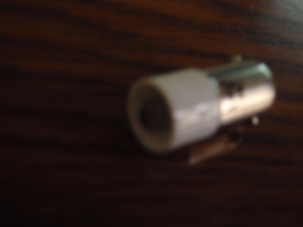

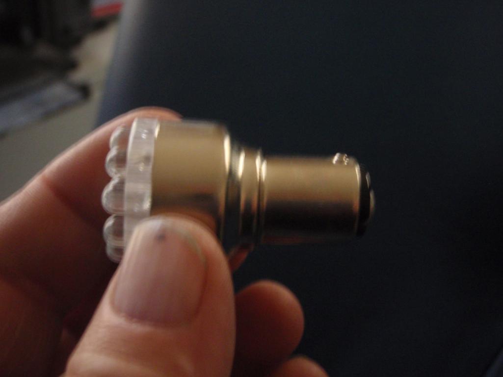

Or,
You could just do this.....
Little Ones Too......
I work for an LED Manufacturer, so I ordered these up for the car, I haven't tried them yet.
Sorry for the crappy photos
John

wndsnd   Or, You could just do this..... Little ...   Jan 26 2013, 09:23 AM
