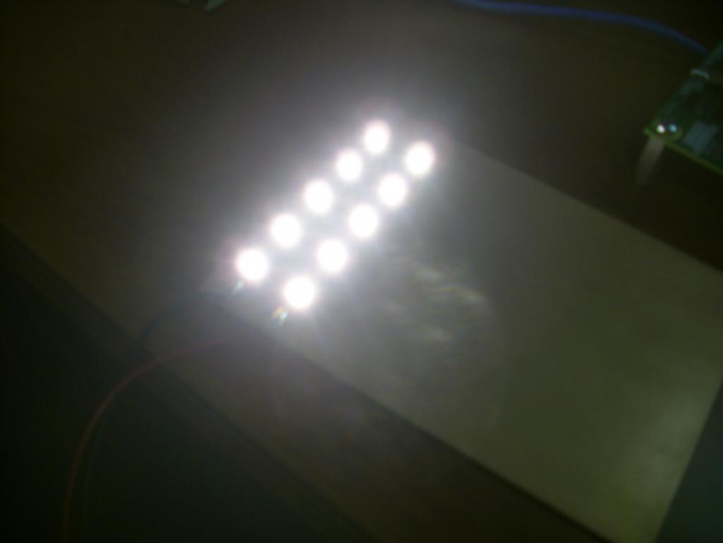

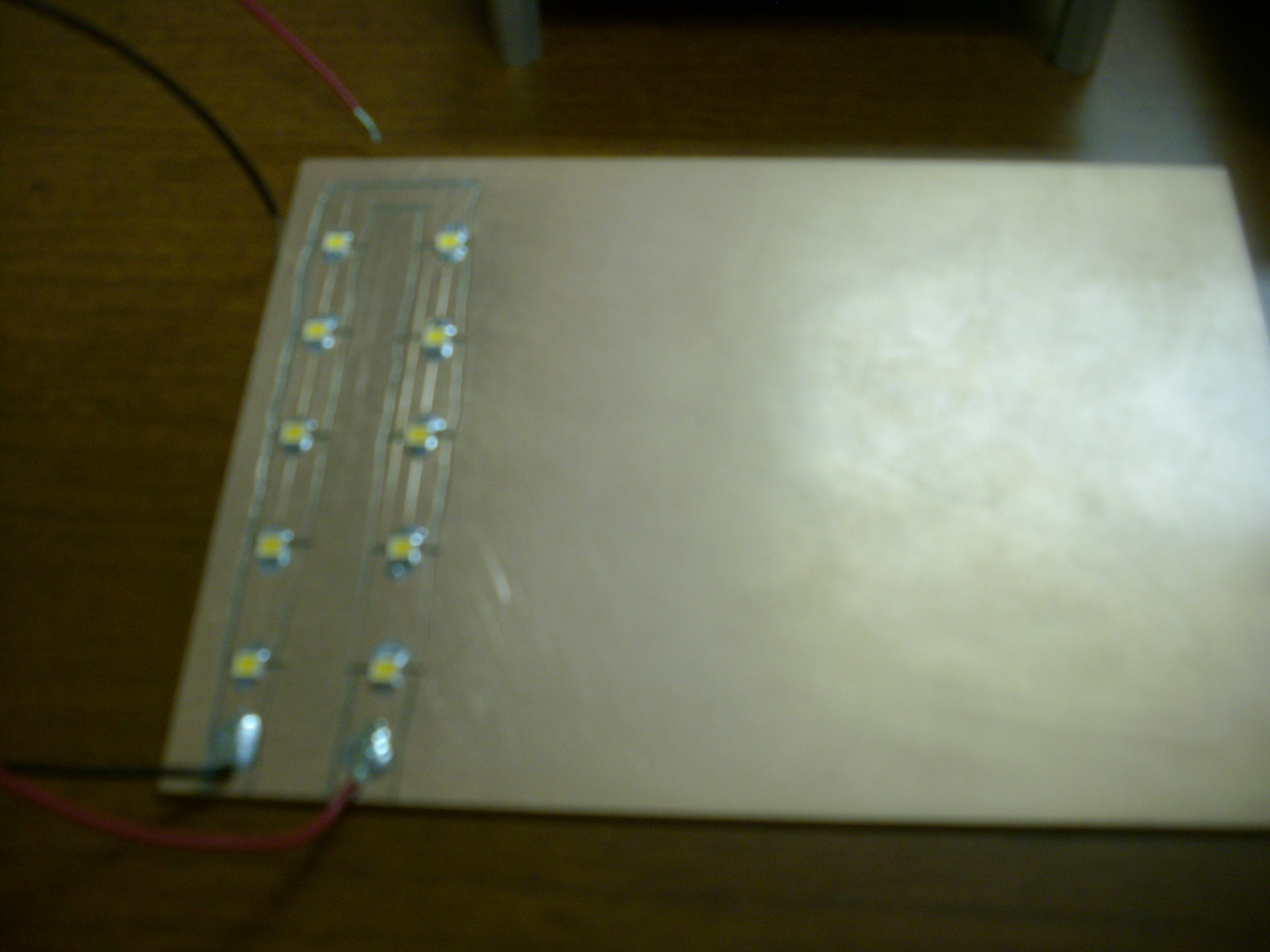

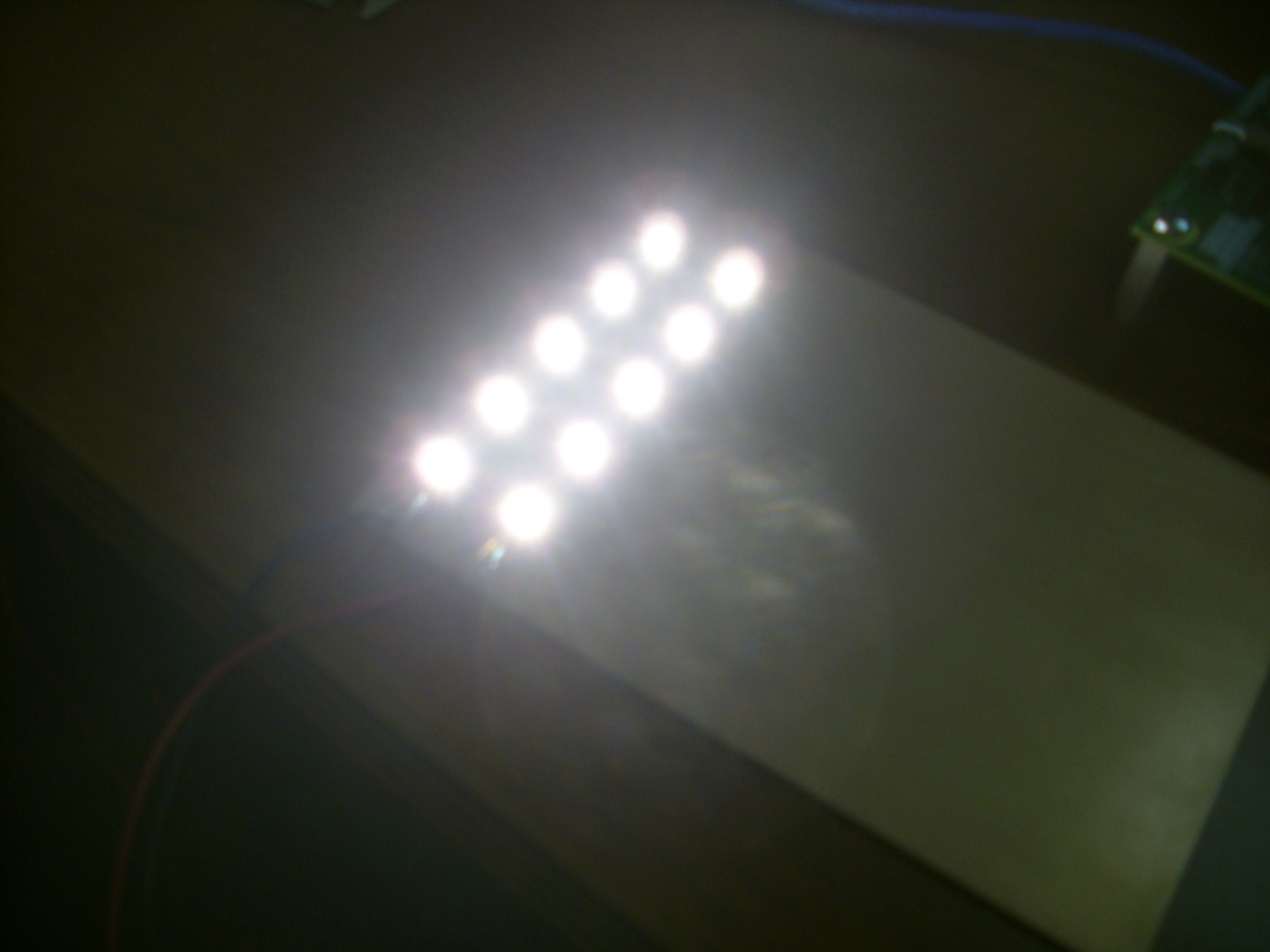

Here's the test fixture that I've used to evaluate the LEDs.
These LEDs are bright as hell but still not bright enough for this application.

Spoke   Here's the test fixture that I've used to ...   Jan 29 2013, 11:52 AM
Spoke   Here's the comparison with the existing brake ...   Jan 29 2013, 11:54 AM
Spoke   The standard backup light is 25W which is slightly...   Jan 29 2013, 11:58 AM
