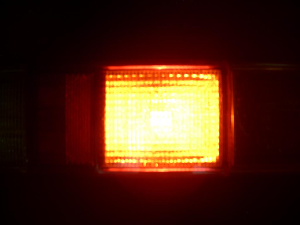

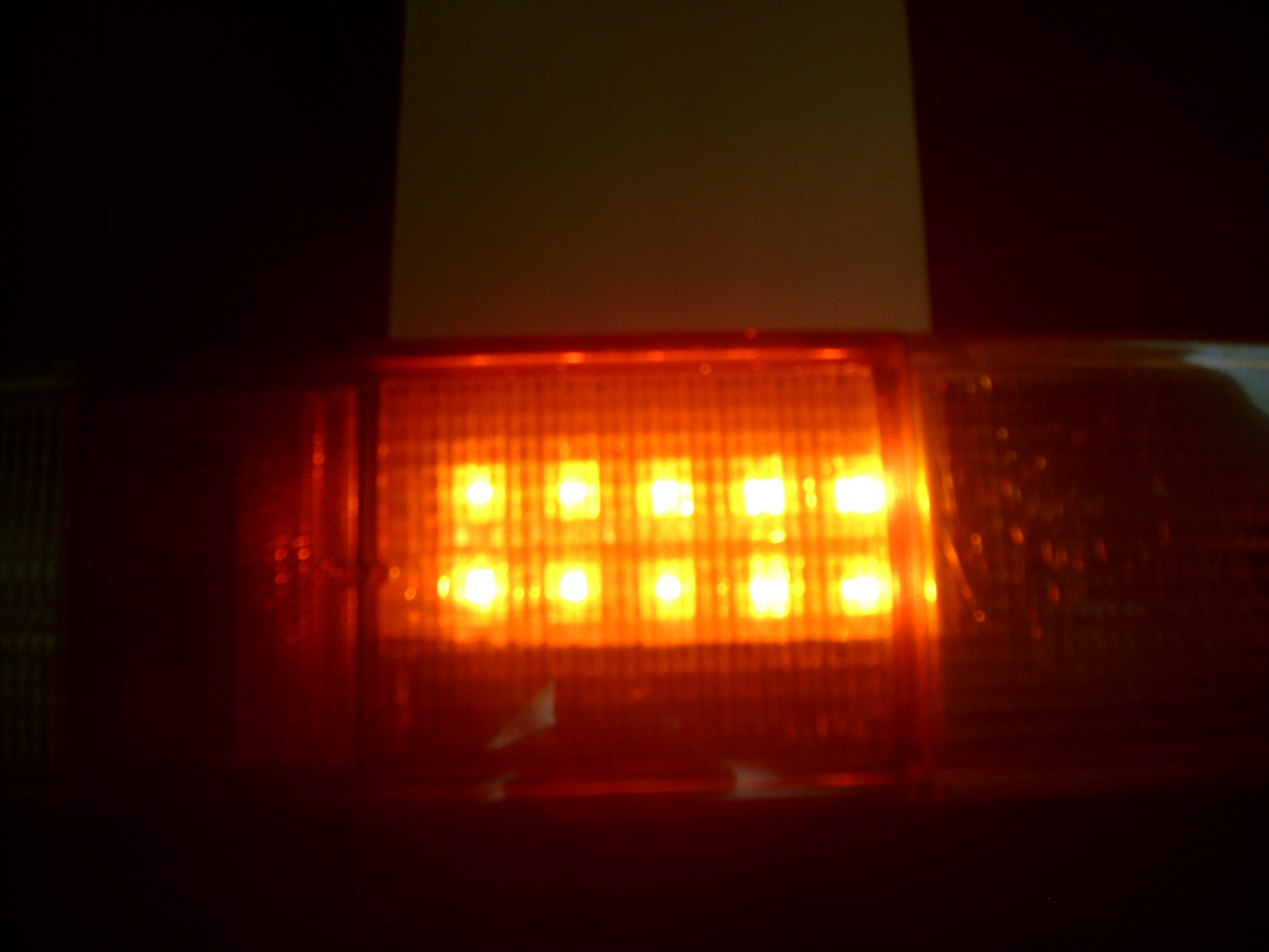

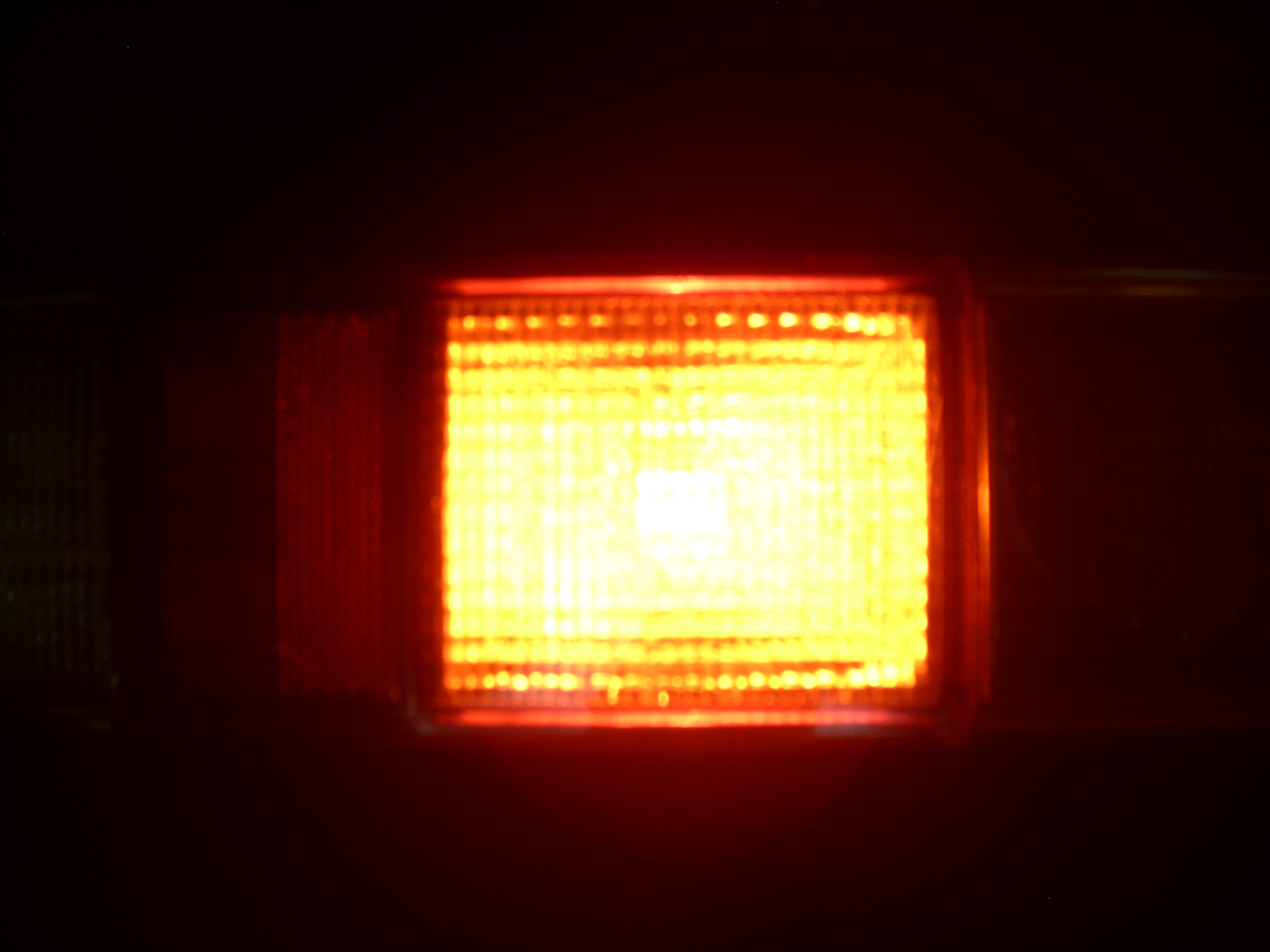

Here's the comparison with the existing brake light @ 13.6V vs the LED. Keep in mind that these are only 1/2 of the LEDs that would be used for the brake lights.

Spoke   Here's the comparison with the existing brake ...   Jan 29 2013, 11:54 AM
Spoke   The standard backup light is 25W which is slightly...   Jan 29 2013, 11:58 AM
