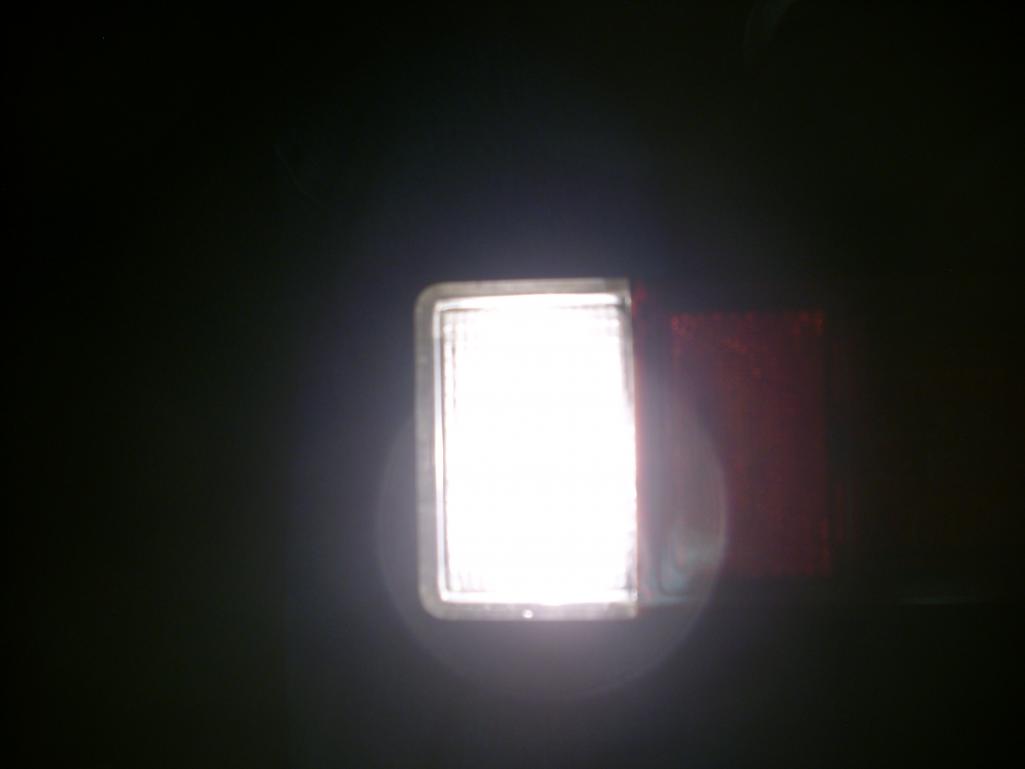

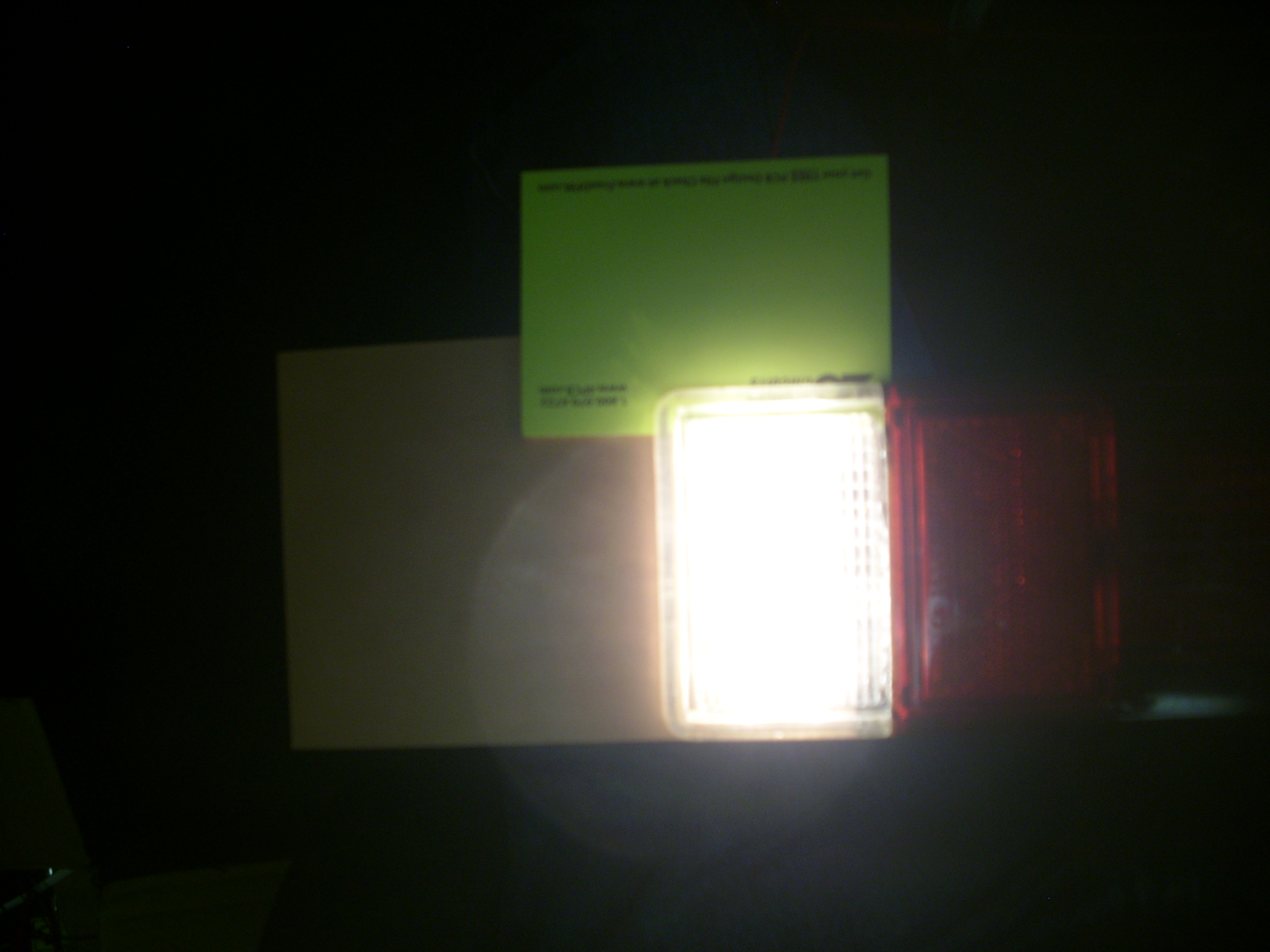

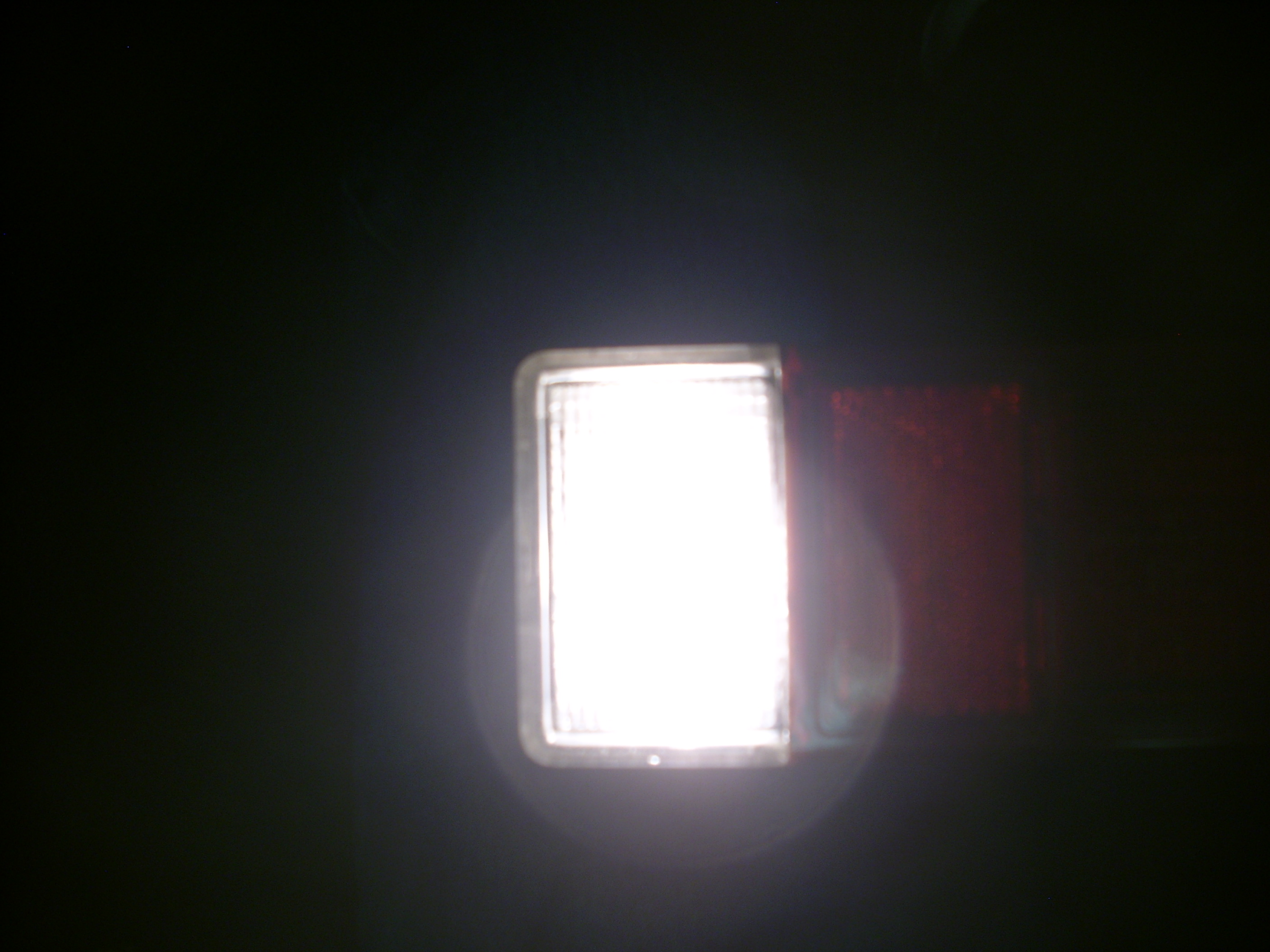

The standard backup light is 25W which is slightly more power than the brake light at 21W.
Here the difference is not so obvious. The next LEDs that I am looking at are about 1.5x brighter.
