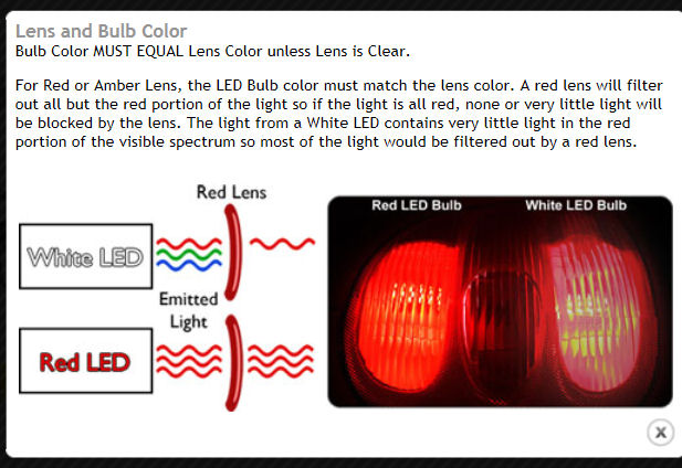

You might consider doing your testing with red LED's. The white LED's produce light in many wavelenghts. The red lens filters out all of the light except for the red wavelengths. If you start with an LED of a given wattage a specific color LED you should get more light in the wavelengths you need.
From the Superbriteleds page:
Harvey

HarveyH   You might consider doing your testing with red LED...   Jan 29 2013, 12:17 PM
