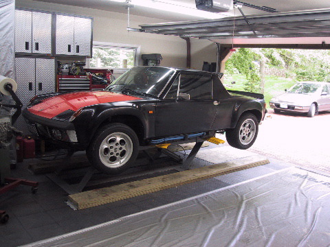

I prefer any lift that will get all four tires off the ground, otherwise I would stick with a good floor jack, snapon and others make nice compact 3/4 lifts that brake or body shops use, if you shop around you can find nice used ones, I picked this one up for less than 400.00. It will get my car up 42".
