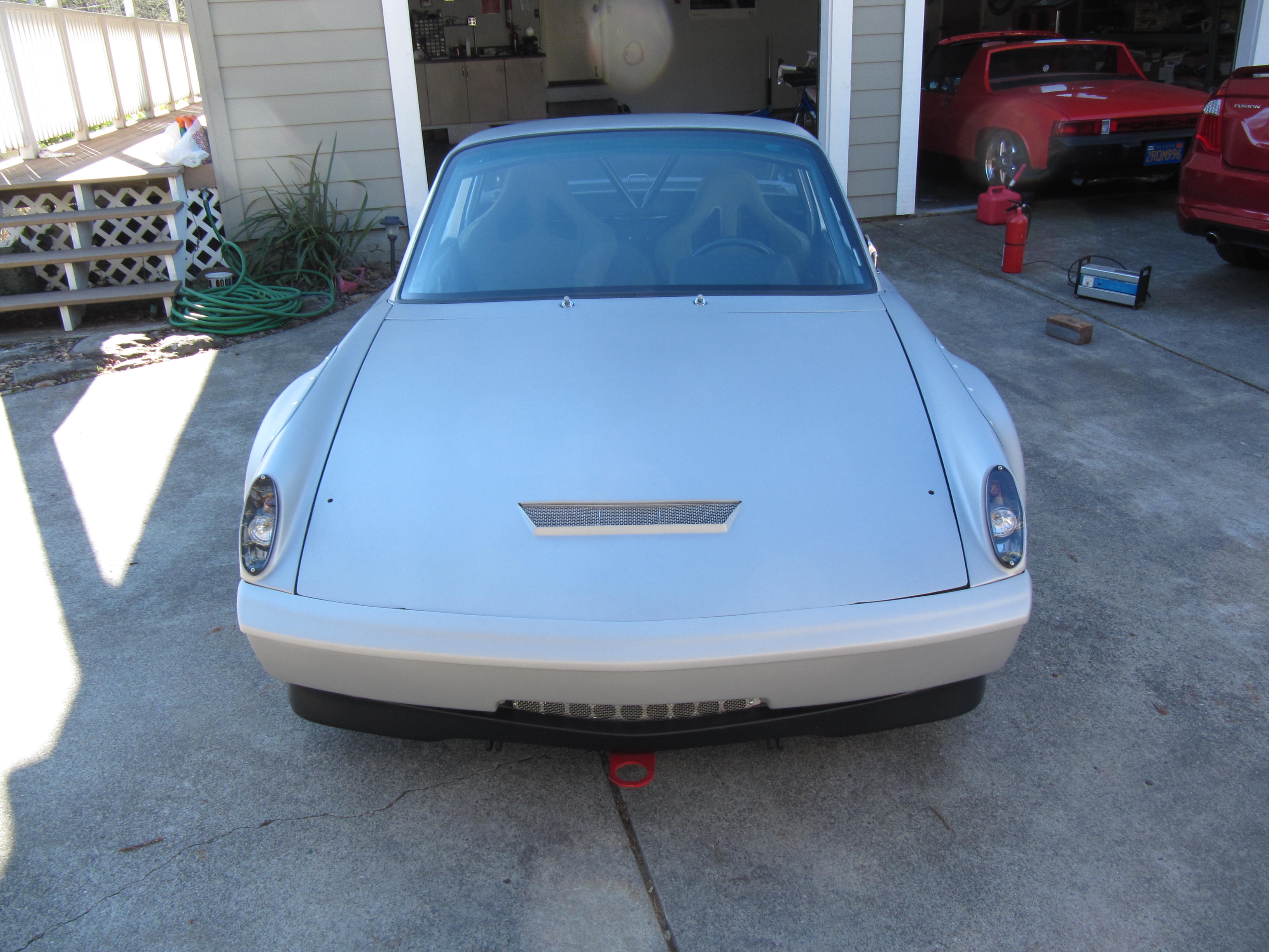

Krieger   I need to do some ignition, carb sorting and align...   Feb 2 2013, 10:49 AM
Krieger   The rims on it now are my street wheels.   Feb 2 2013, 10:52 AM
