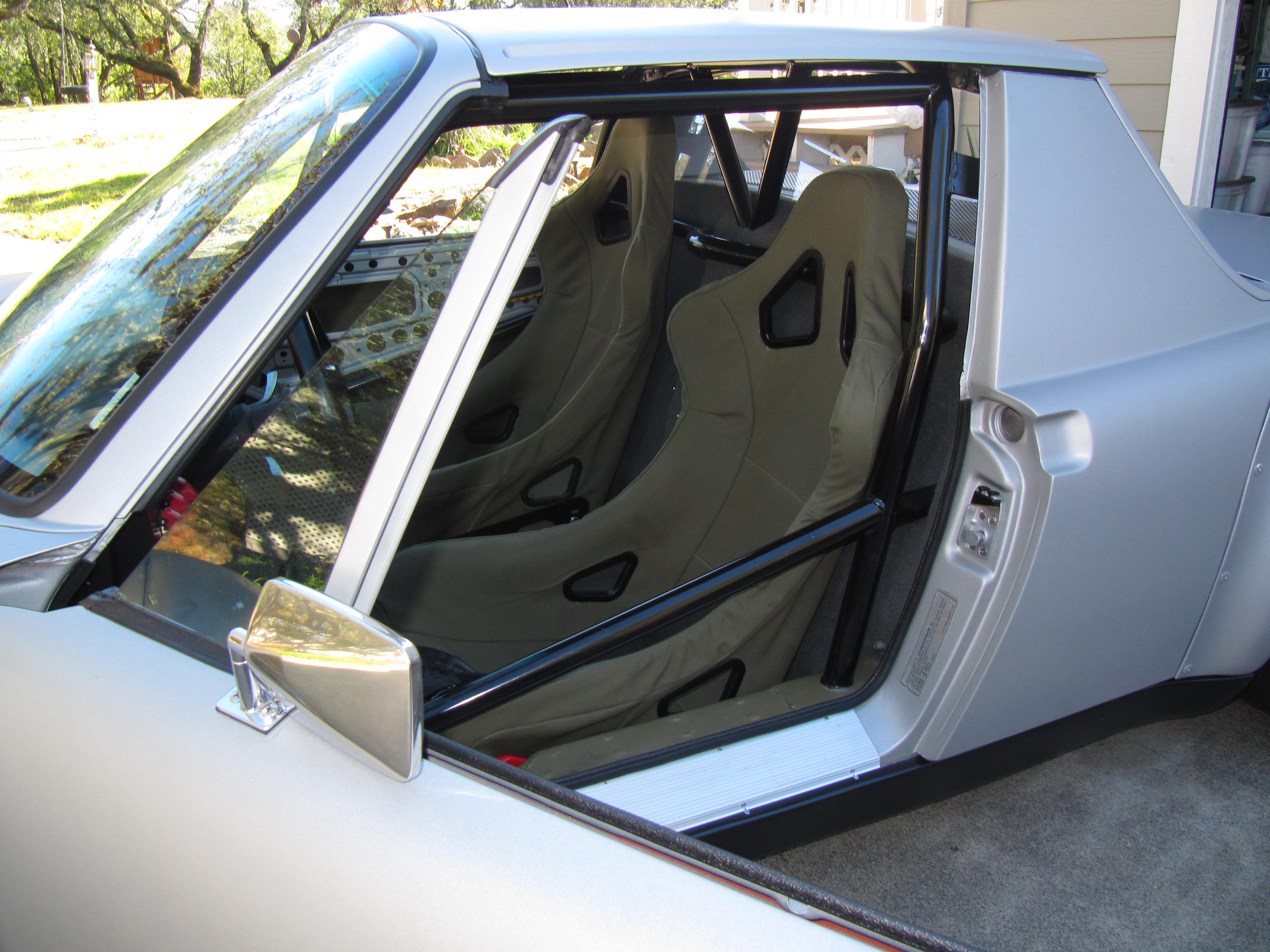

Krieger   I had my OMP seats covered in army style heavy OD ...   Feb 2 2013, 10:54 AM
