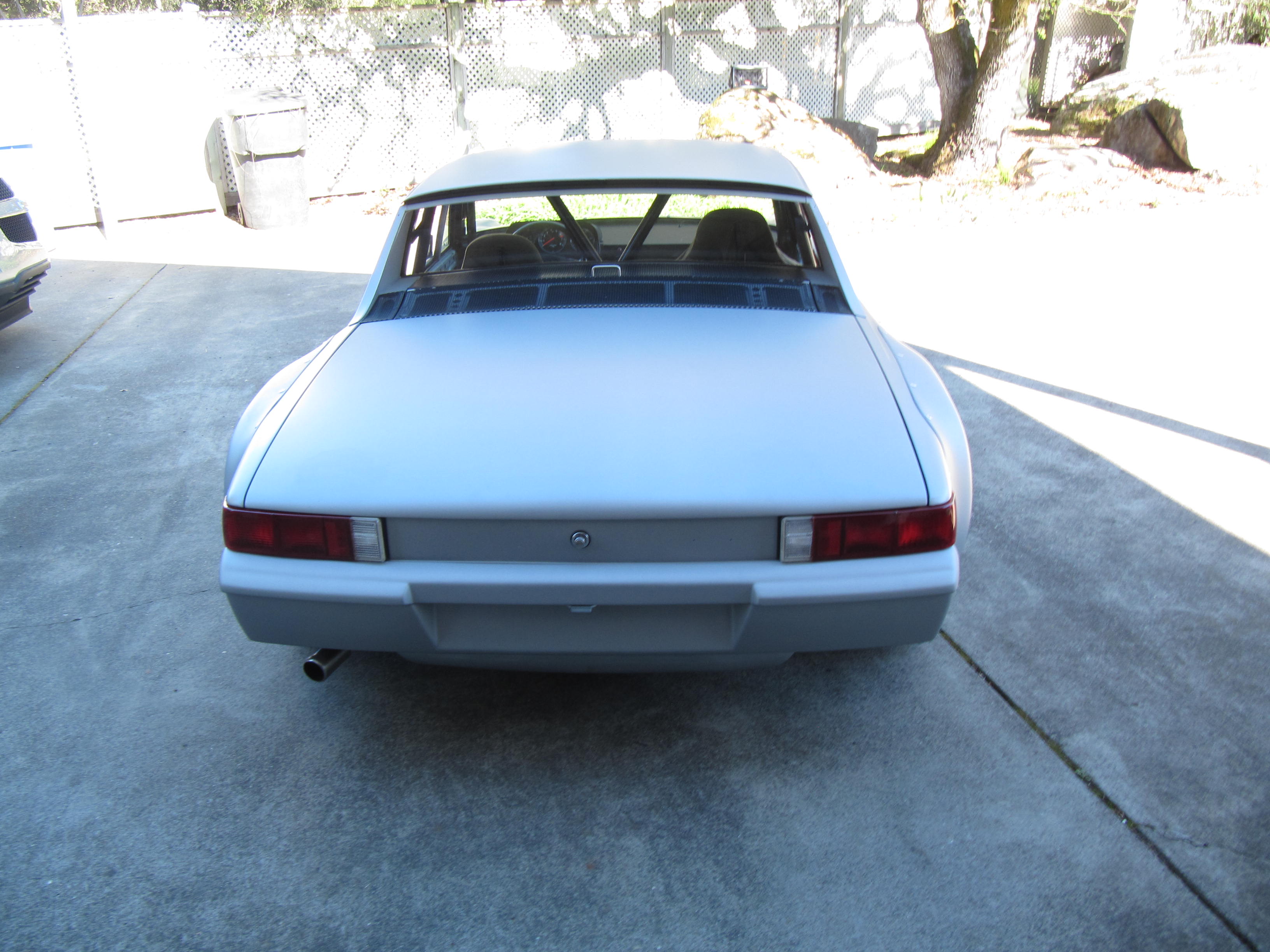

Krieger   All trim!   Jun 24 2012, 01:08 PM
