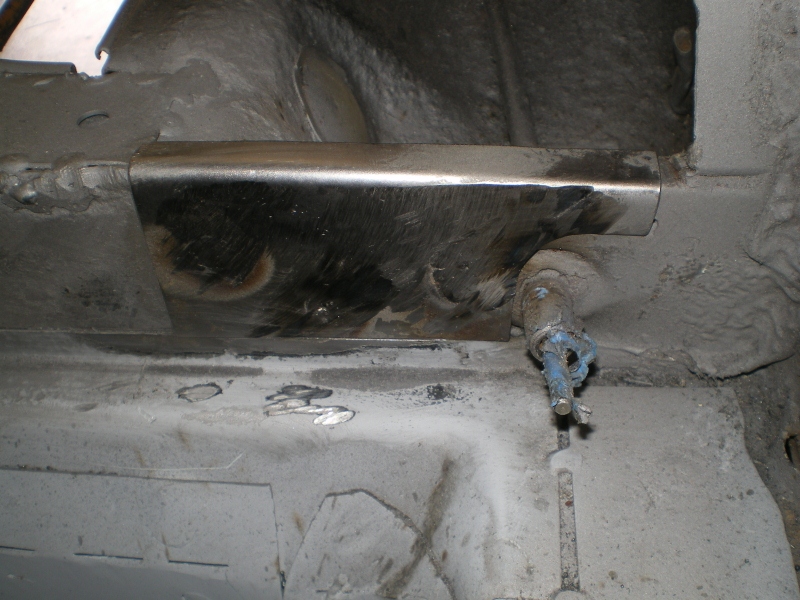

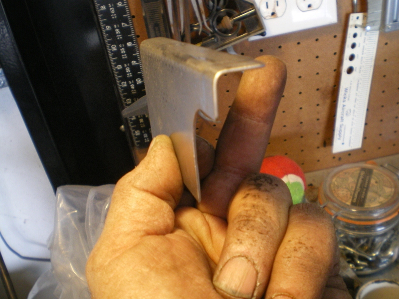

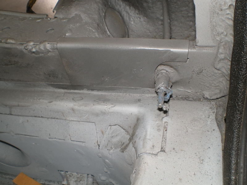

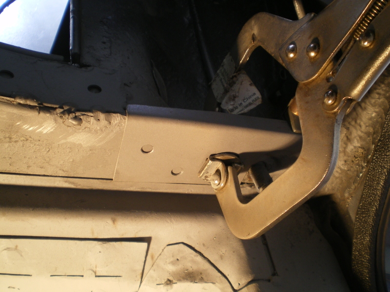

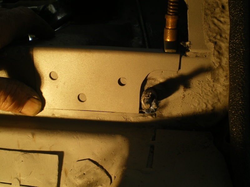

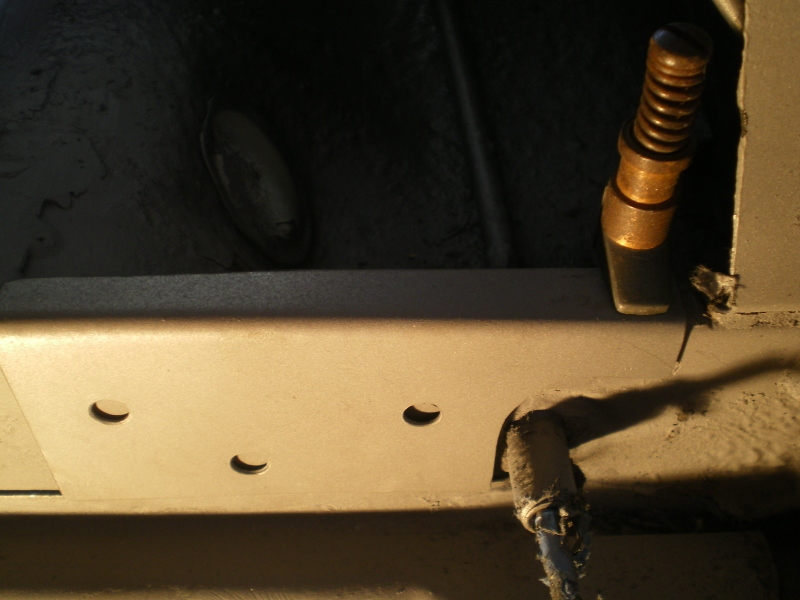

Here we see it taking shape..

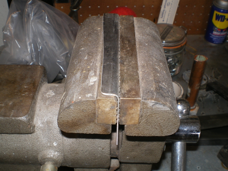

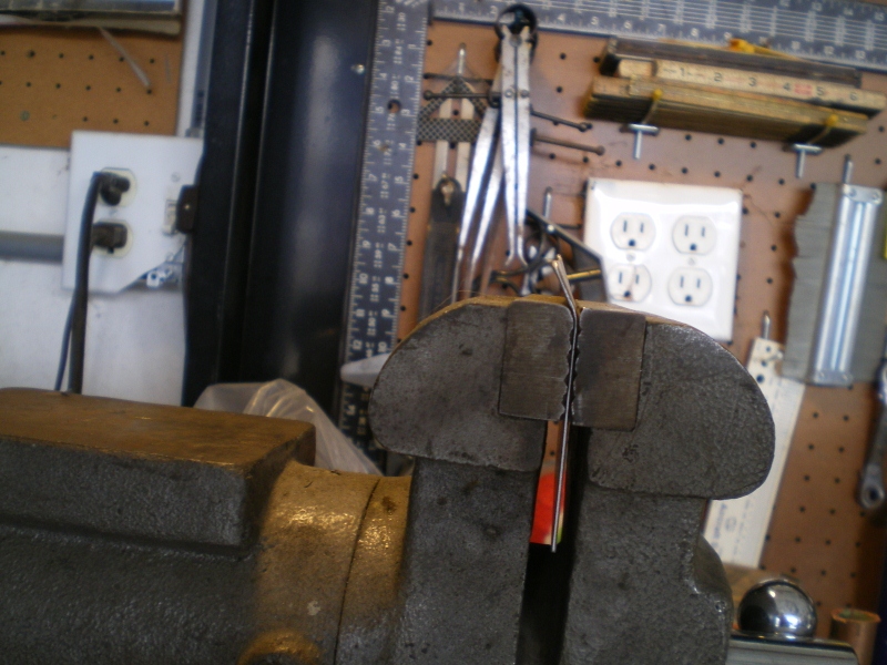

Now it is almost flat or at a 90' angle but that's as far as it is going here because of "springback" so I remove it now. Yes, I see the edge needs trimming.
Here is the piece out of the vice, Just needs some weld holes drilled into it.
And fitted into place
And welded in place
