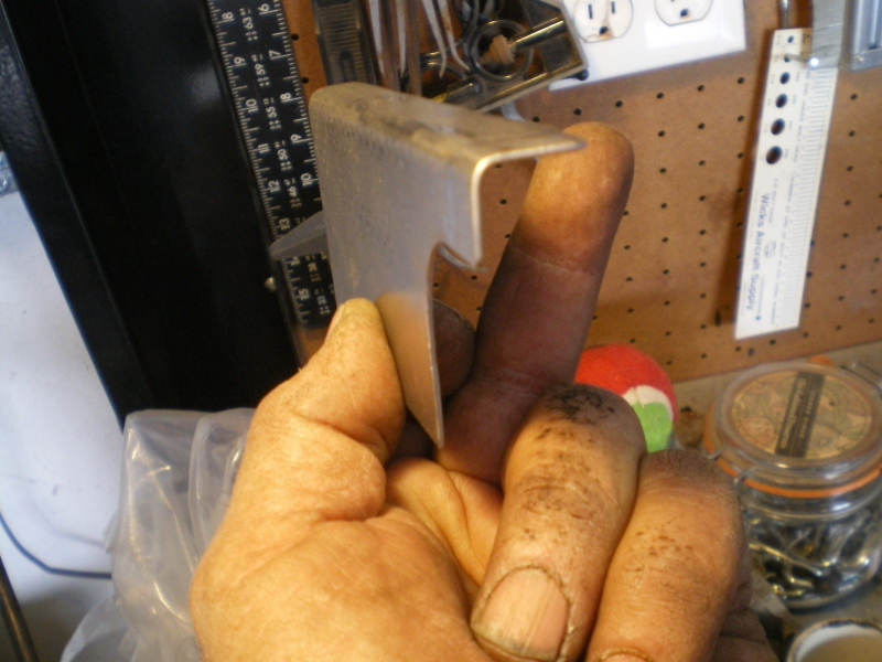

76-914   A few blanks Wurther'd into place Another...   Feb 24 2013, 08:18 PM
76-914   I'm going with a very good heater hose but not...   Feb 24 2013, 08:30 PM
