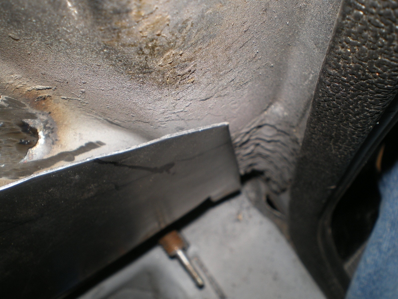

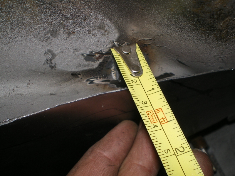

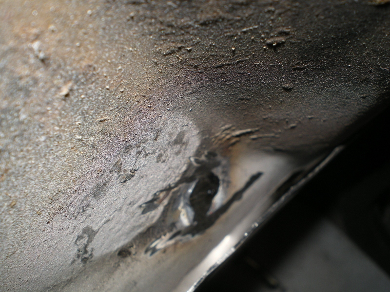

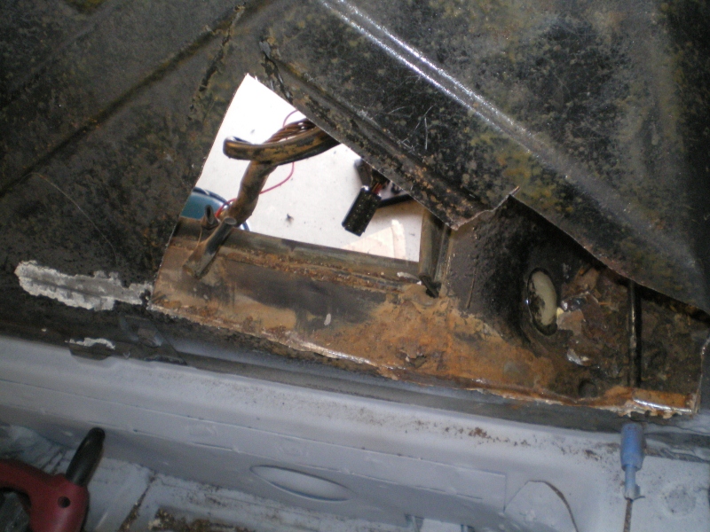

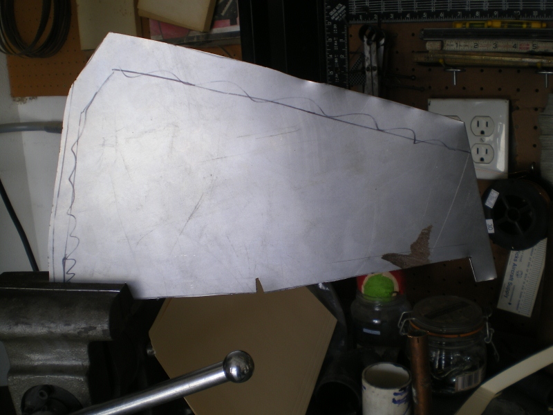

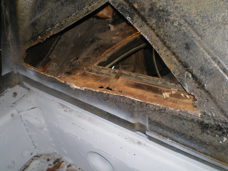

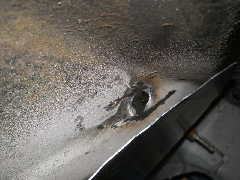

Hah, good one Andy! Just trying to hold it for the pic. I finally received the 20 ga metal today. First time they shipped 17 ga, oops. Anyway they were great about it. Bobco metals in LA. They are on the net and ship. Remember this? The psg side
and the drvrs side

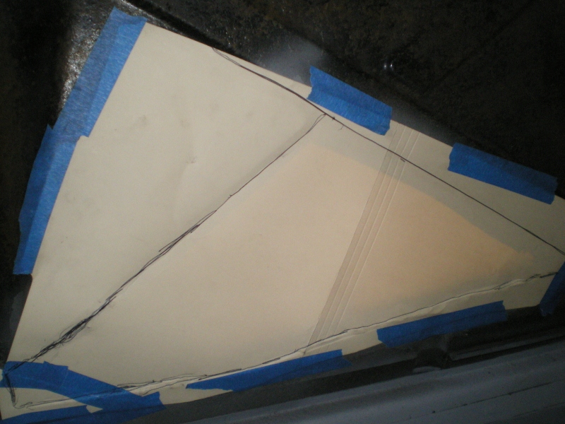

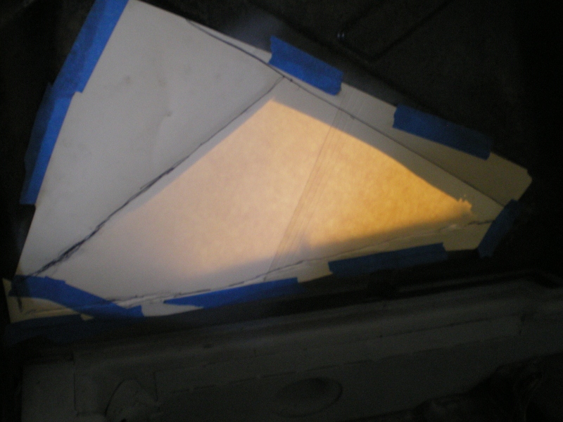

Here is a shot of the psg side pattern being traced
with the flash off you can see what I see, easy enough to trace out

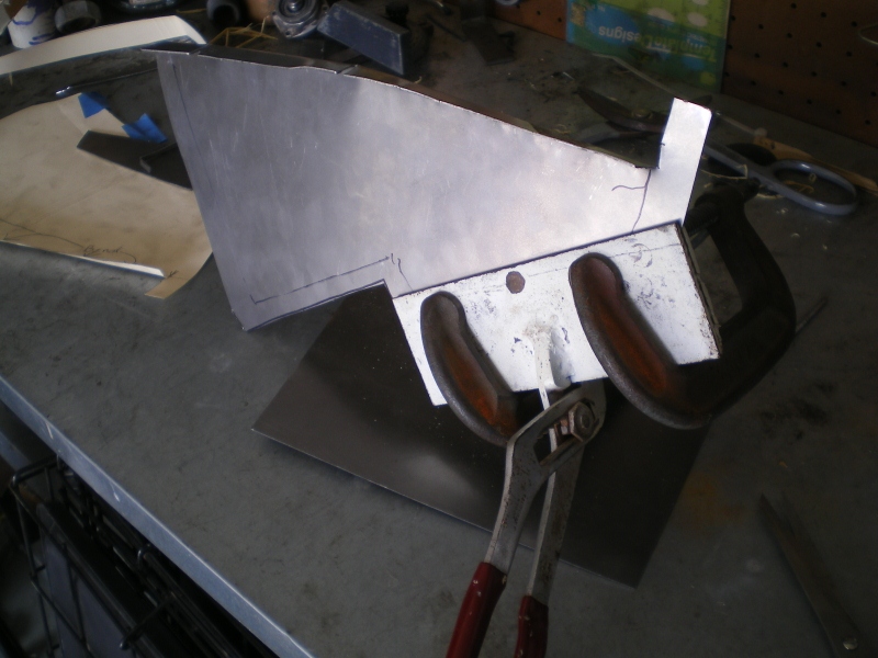

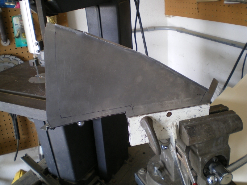

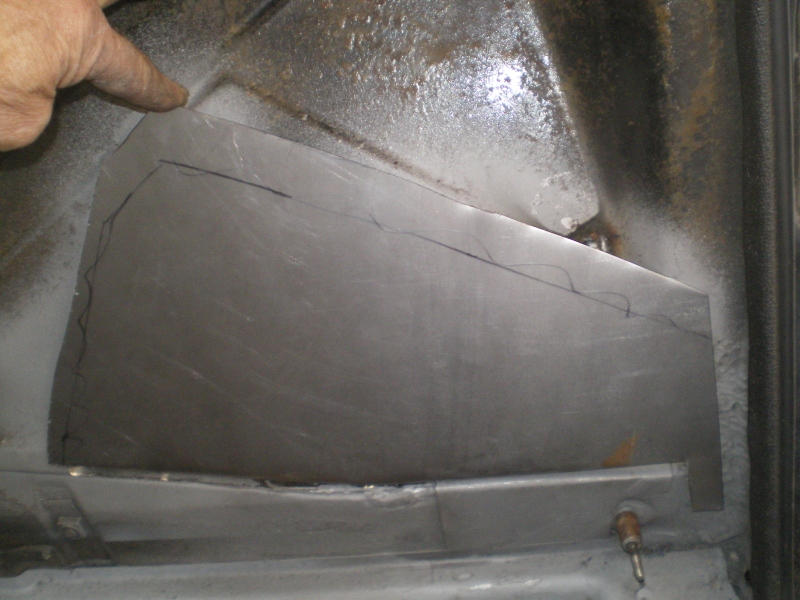

this is the first rough cut of the drvr side firewall patch piece
The piece placed against the firewall to check overall fit and mark for trim

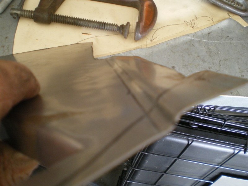

and a compound curve

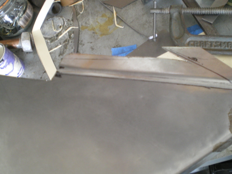

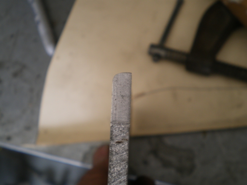

this is one of my CSOB tools I made out of water pump pliers and an old lawn mower blade years ago. with the piece firmly clamped a piece of .050" (6160) aluminum which is radiused, shown in the next pic, is driven into the steel right next to the fixture holding it. This is what created the raised portion that was necessary to meet the existing material
starting to take shape
