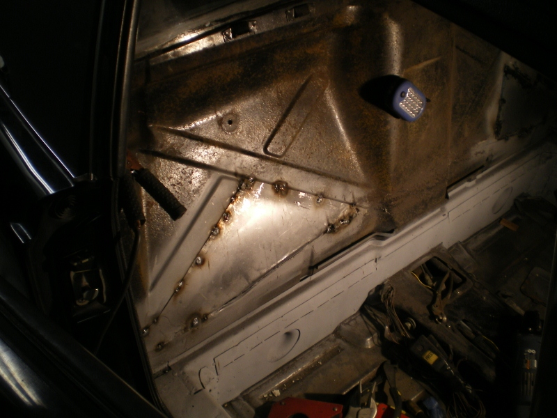

What's it been? A year since I got Blackie running. I finally get it tuned to a daily driver status and should have been happy as a Lark then but what do I do? I sold the engine (w/90 hour's on the Hobbs) on the last Dawn Patrol GMR run. So I pulled the engine and began preparing Blackie for her transformation.
Before I go any further check out my Jack Stands. Min height 19.5", 12 ton and should hold up to a 6.7 quake or direct nuclear attack.
And out she comes.
One thing you have to love about these cars is that you can remove an interior in 15 minutes. 30 min's if you have a console. This was one shot before the interior is gutted.

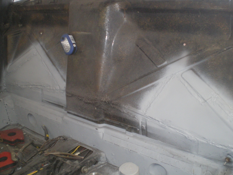

and an hour later I'm scraping tar floorboards.
76-914

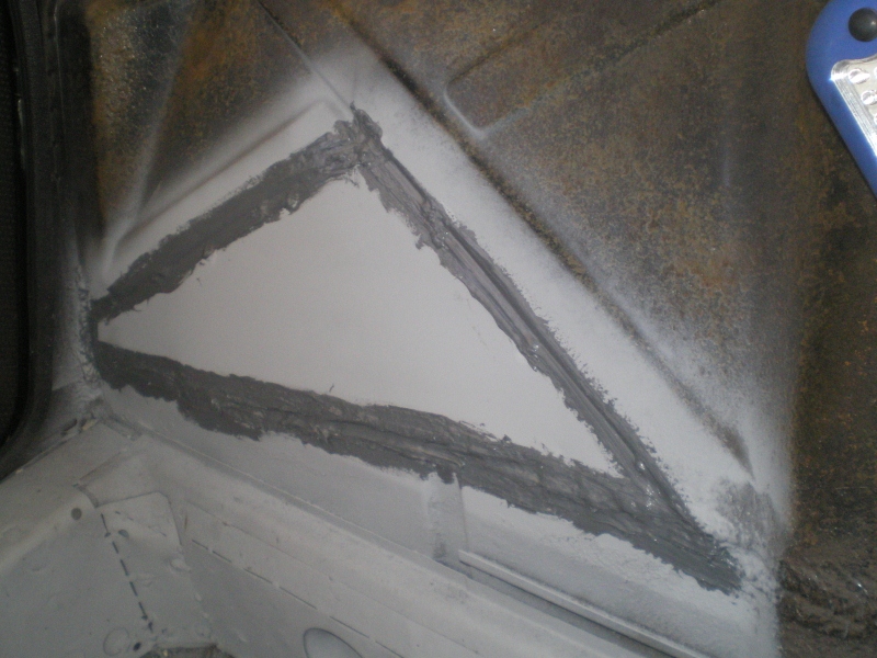

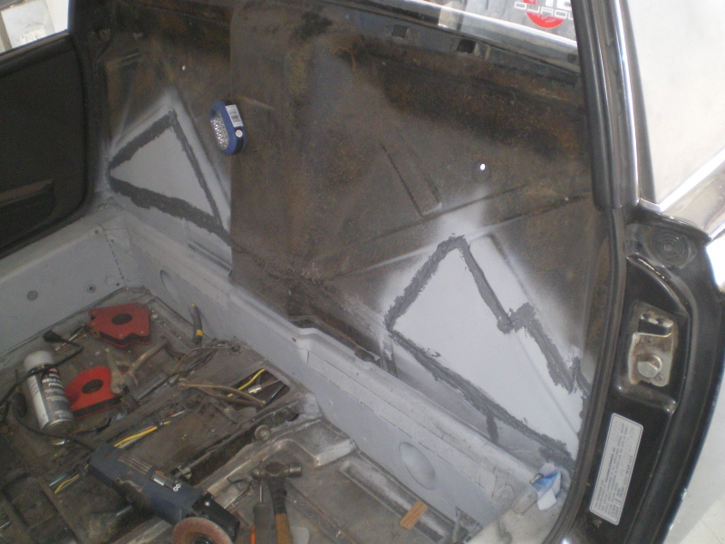

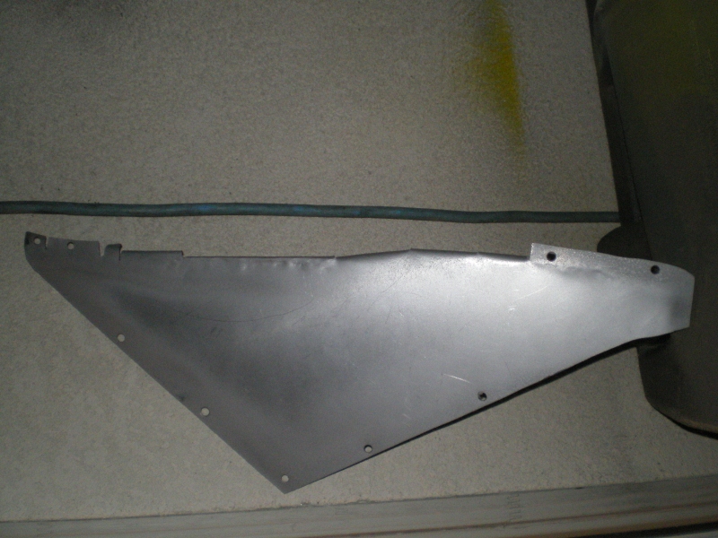

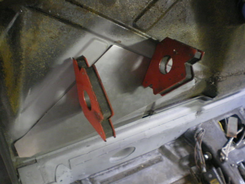

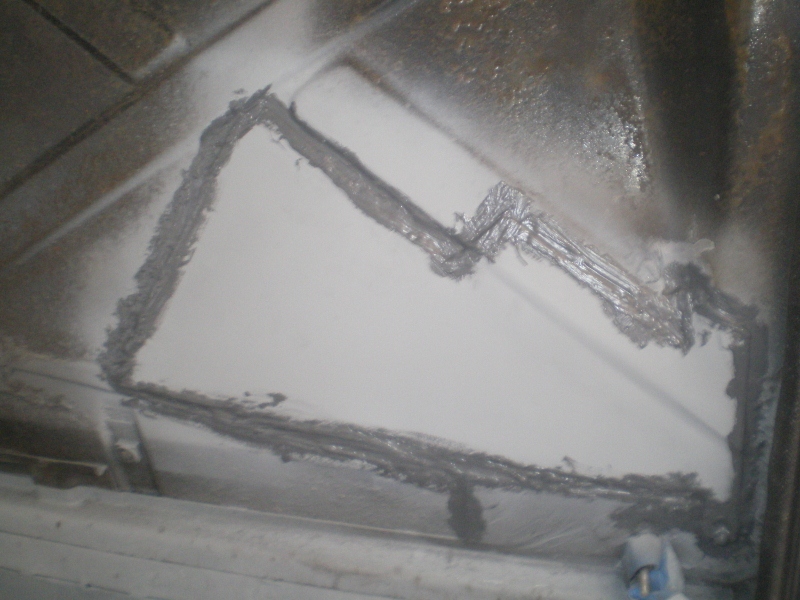

and the pass side, not much to it
a little grinding and a little primer then it's on to the radiator

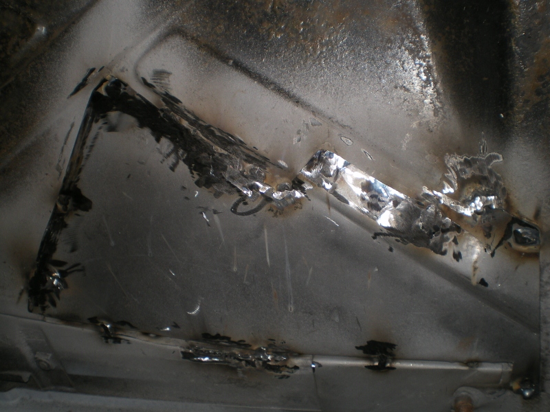

76-914   I got around to welding on the r&l long stiffn...   Jan 20 2013, 10:05 PM
76-914   When I was banging around bracing the panels with ...   Jan 20 2013, 10:06 PM

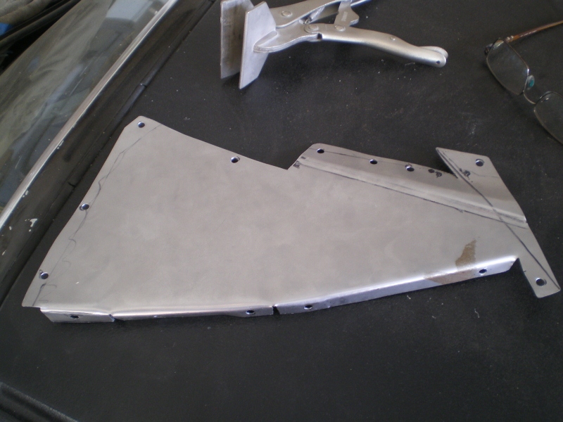

76-914   Well, with the rust repair (I think) behind me it...   Feb 7 2013, 04:59 PM

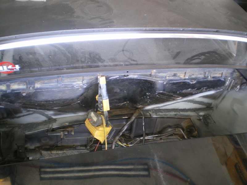

76-914   The top/cover piece slides beneath the rain channe...   Mar 9 2013, 11:06 AM
