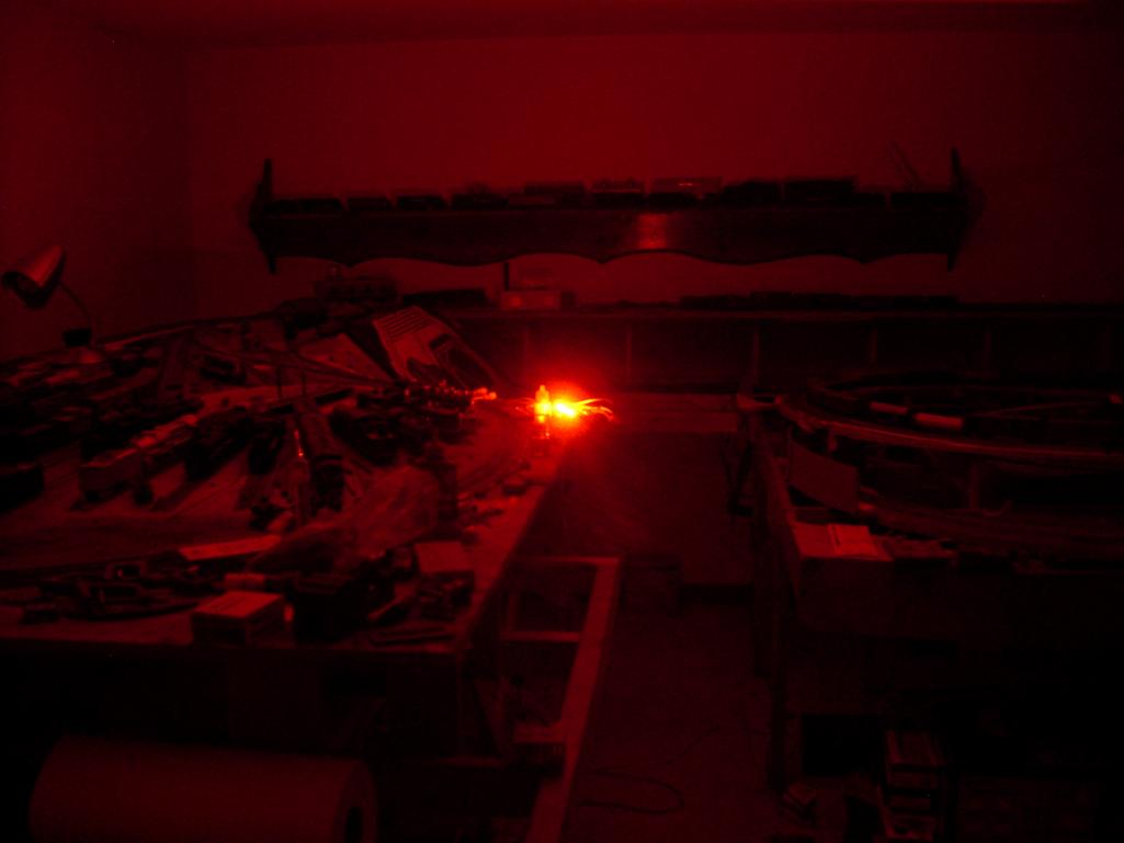

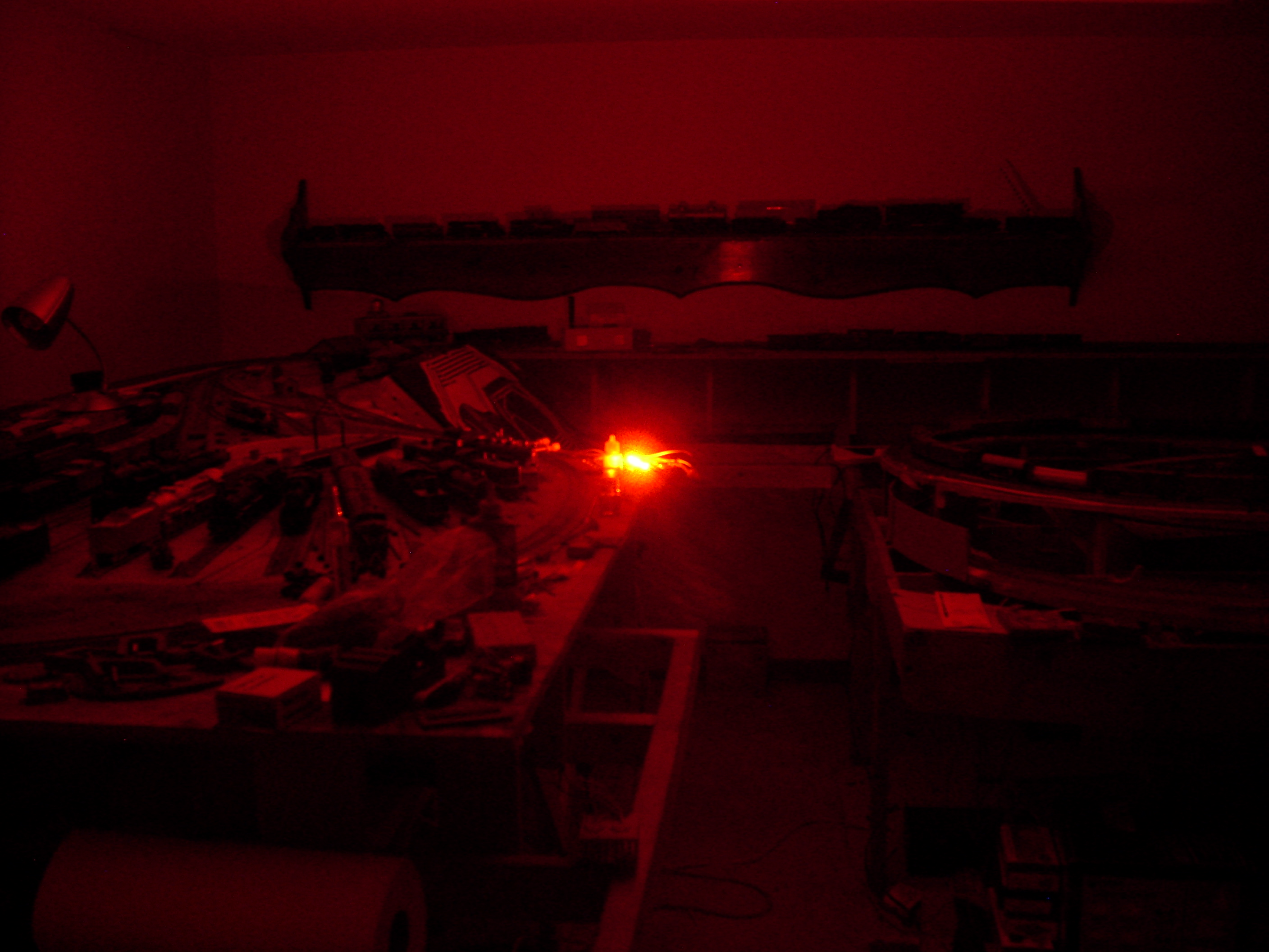

I started testing the next batch of LED samples looking for some more efficient LEDs. Also doing red, amber, and white LEDs.
To get higher lumens, got to go to LEDs with higher current capability. The one in this post is a red LED with test lumen of 71lm @ 350mA and max 170lm @ 1Amp.
These suckers are BRIGHT! I quickly realized when testing these that viewing them with my eyes is dangerous. I was running 150ma through 5 of them and I would estimate that they are about as bright as my current filament brake light bulb. I plan to use 20 of these.
So for this testing, I have to be careful not to look at them at any angle. I put my hand on them and I swear I can see my bones. (IMG:style_emoticons/default/shades.gif)
Cree Red LED
Here's a pic about 6 feet away from the LEDs at about a 90 degree angle with no lights on.

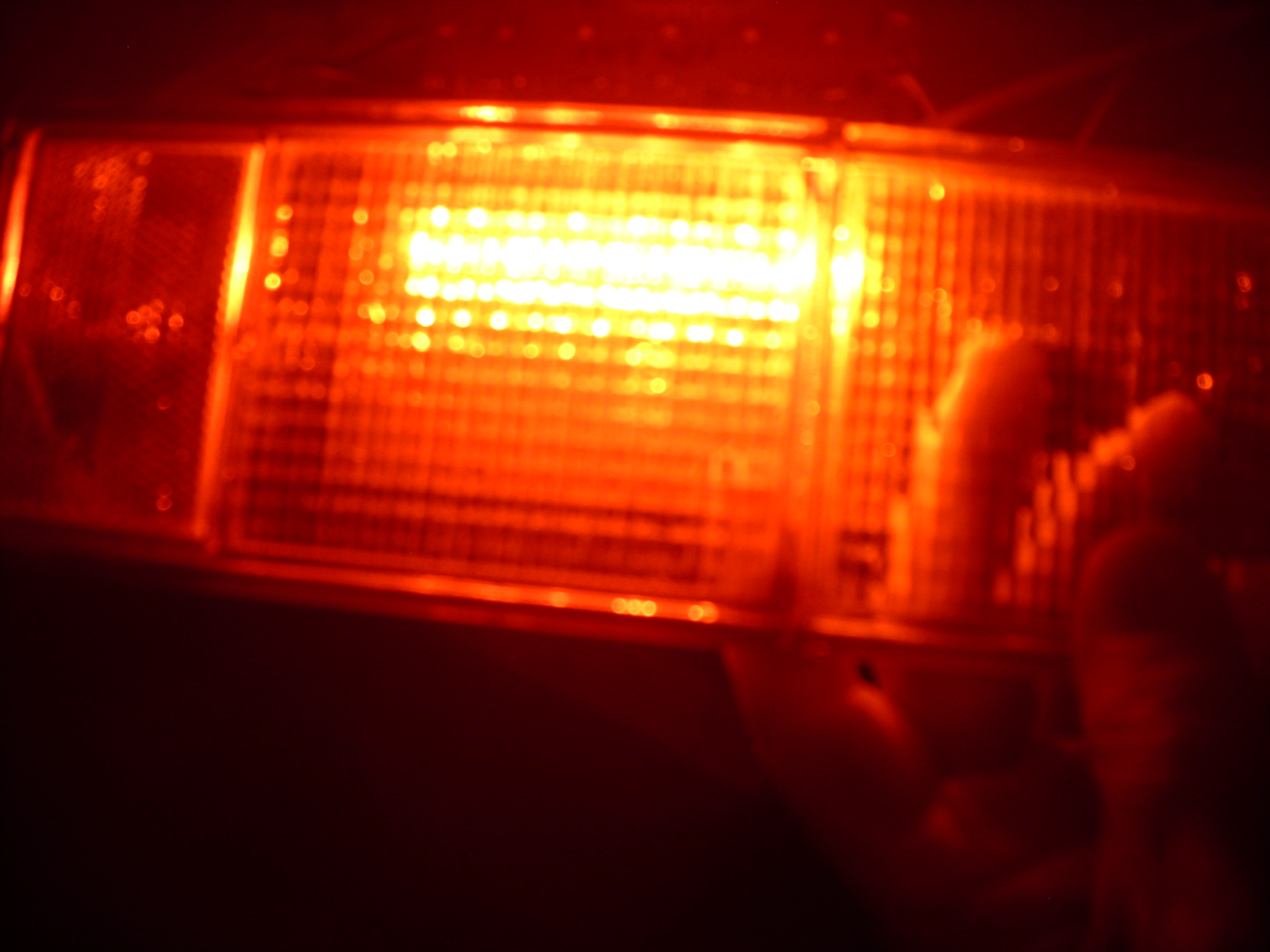

Red LEDs viewed through the brake lens. Being only 5 LEDs. With 20 LEDs I will have no issue with brightness. After about 10 minutes at this intensity, the temperature of the LEDs is barely above ambient.
